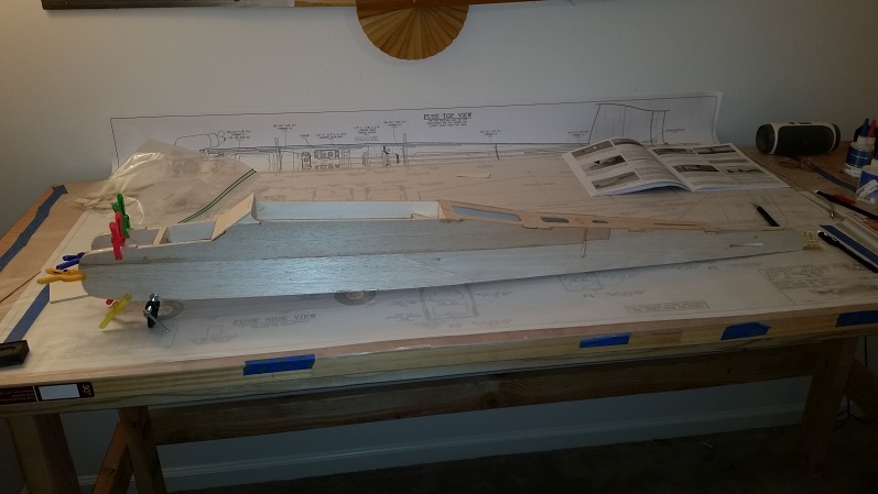

Thanks for all the good info and words of encouragement! It's settled, I'm building wing B with ailerons and a bolt on wing. Once I took the clamps off the firewall and wing bolt plate I didn't like how they fit together. The edges are uneven by .5 to 1mm. I'm thinking I want to file the edges smooth but don't want to take off too much material. It might be better to wait until I get to installing them into the fuselage before I do any adjusting. The gap in the fuse I was talking about you can't see unless you hold the part up to the light so I'm not gonna worry about it. I am starting to see the value of reading the WHOLE manual before starting instead of reading ten pages ahead. I might take a break from building after the step I'm on to finish reading the manual. Besides if I keep going the way I have been I'm gonna need an engine soon. I am thinking OS .46 AX.

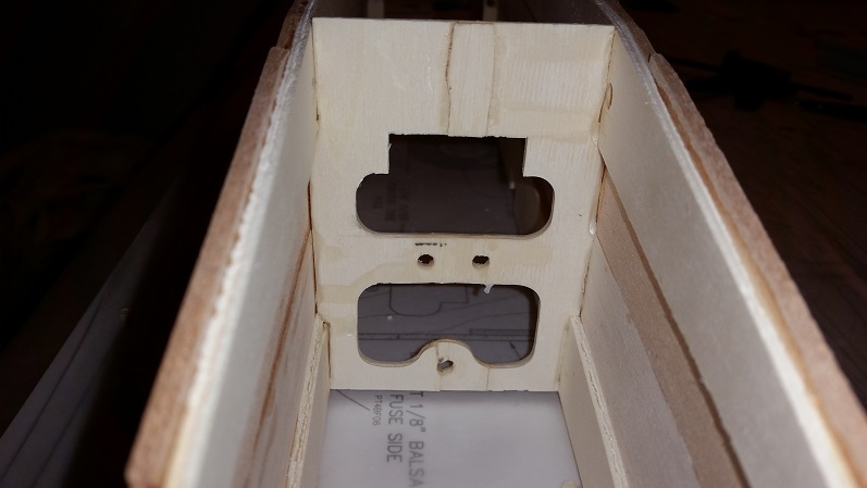

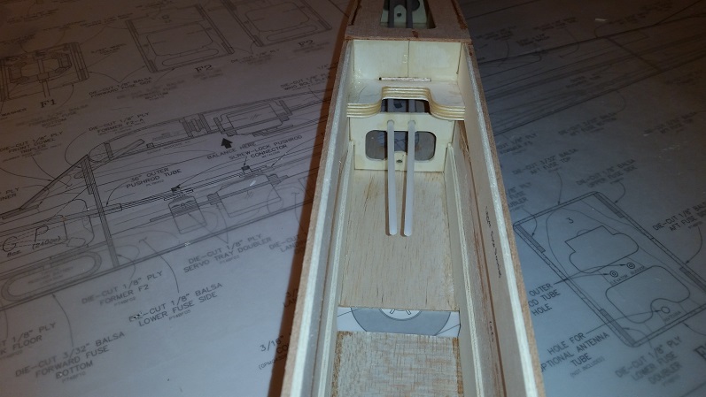

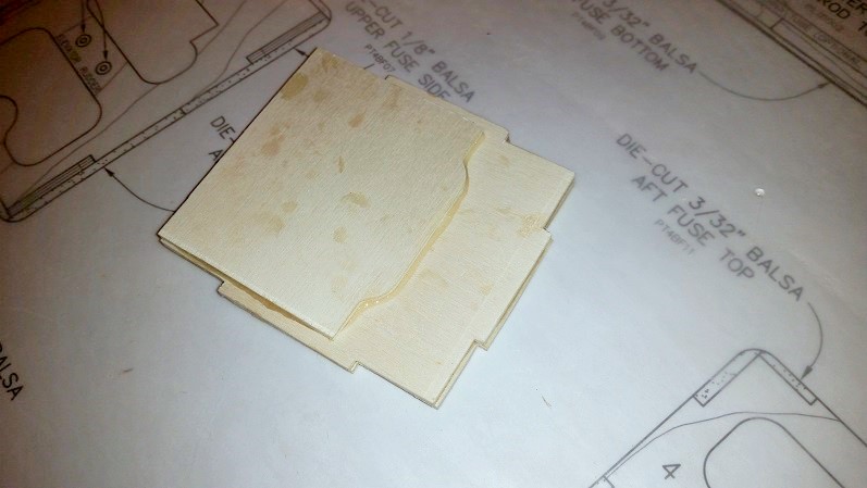

Well, I did my first major screw up today. When I was gluing the fuse sides together I put too much pressure on it and broke F2 and F3 formers. Luckily they didn't break all the way and I was able to glue them back together. I test fitted some of the other fuse parts and everything fits good and it seems solid. I might have gotten away with it. Right now I have the firewall epoxied in and curing. Here are the pics of my ugly fix. Ugly but hey, it works.

Let he who hasn't done something like that raise there hands!! My big thing is breaking wing ribs while I'm sanding. We once talked about that in a thread and it seems I'm not the Lone Ranger.
Old 01-03-2015 | 04:48 PM
  #37
TomCrump's Avatar
Joined: Apr 2003
Posts: 7,614
Received 5 Likes on 5 Posts
From: Traverse City, MI
My thing seems to be breaking fuselage stringers....................sometime the same one, multiple times.

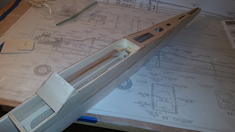

Things have been moving along much faster than I thought. Most everything has been going together well. When I glued the fuse bottom on I glued the masking tape to the fuse. PITA but I got it sanded off. Probably should have used medium CA instead of thin. Then the wing bolt plate and former F3 had a gap in it that I filled with a shaved down piece of balsa. Other than that I have some small gaps but I guess that is to be expected. I will probably fill them with the filler I use for the control tubes. Now I need to get an engine. I want to go OS but am not sure if I should get the .46LA or spend the extra money and get the .46AX. Since this is my first plane I'm kinda leaning towards the LA to save money.

I would spend the extra bucks for the 46ax. That's what I did. I ran it on my trainer and then mounted it on my easy stick after it learned to fly. . It will scream on a sport plane. The AX will last a long time with ball bearings.

Chances are that you will take the engine from this plane and use it in several more airframes. I have an OS .46FX (?) that has seen 5 or 6 planes and is still running strong. The LA will serve you well in your trainer (had one in a Goldberg Eagle II), but as you move into sportier types of planes you might be happier with the AX... Just my thoughts...
