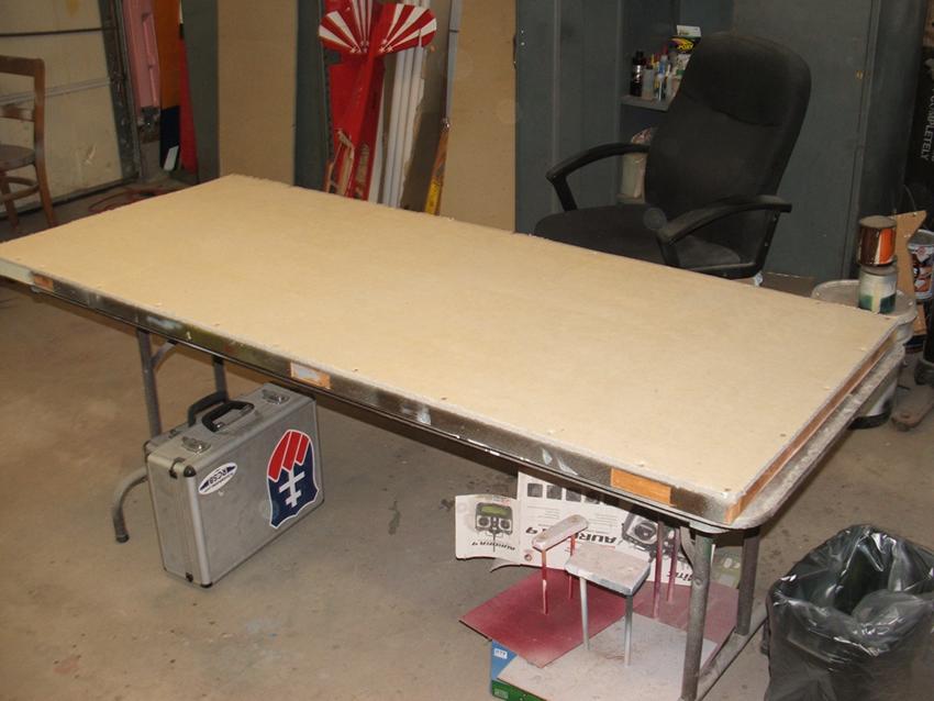

I like the suggestion to use homasote. It accepts pins well.
Homasote comes in a 4x8 sheet so if you save the off cuts from covering the door you can make a few small portable building surfaces. These are great for smaller subjects or even sub assemblies and I can even stand them up against the wall with the parts pinned in place.

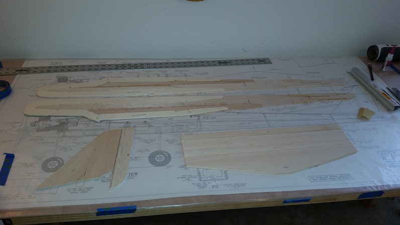

I got the fin and stabilizer glued last night. They turned out flat and smooth. The wax paper stuck to the stabilizer but that was easily sanded off. Now its time to start on the hinges, tomorrow.

Nice start !
Lately, I've been using plastic wrap instead of waxed paper. You may want to give it a try.
Yes sometimes the wax paper sticks to the odd glue joint as you said it easily sands off. I find it sticks more as of late I think they are using less wax in the wax paper. I may try something like a light layer of car wax on the wax paper. Pin it down apply the wax and buff it off. I have tried the plastic wraps and I didn't like them though I know many who use it. If your getting it really stuck to the glue joints you may be using to much glue. I like to lightly glue all the joints then go over them after the structure is removed from the table. This way I get the bottom as well.
