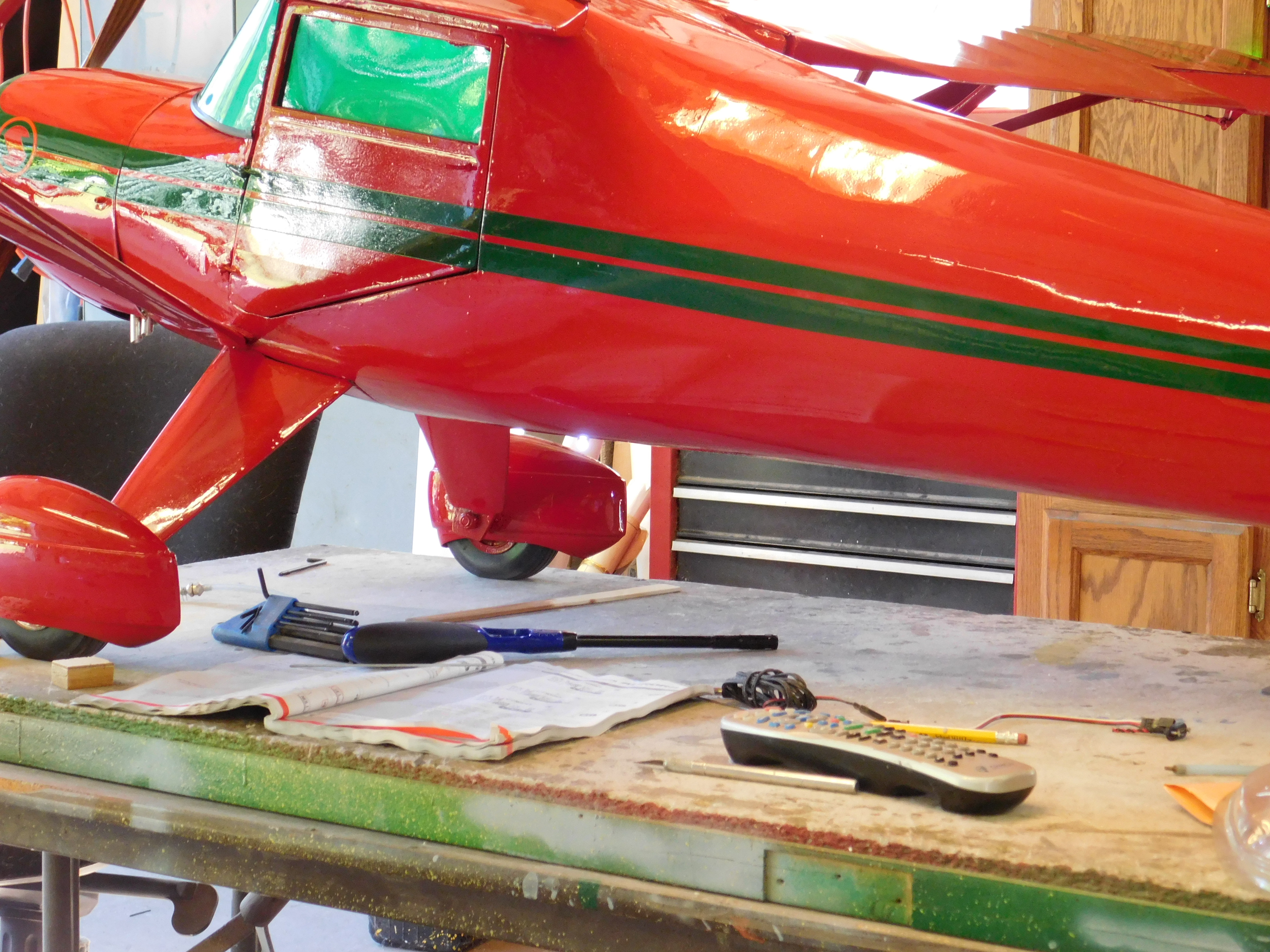

My last two models were glassed, using polyurethane (oil based) and .58 cloth.
ID:	2208044   Click image for larger version
