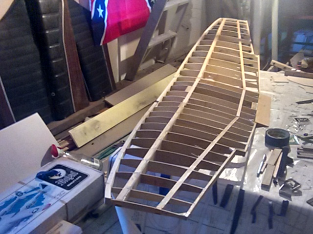

Hello everyone... Working on my Spitfire & I kinda would like to build the clipped wing version, but before I do, I'd like to make sure the low speed characteristics​ - will they be better? Also, I think I may try those VG' jobbies I read about in the model aviation magazine, February 17...VG (vortex generators) claim only a 1% reduction of top speed, now if these really work, that trade off is excellent, there's 2 different style, really noticable & not so much, the bummer is.. scale warbirds will look funky with those on there....& If I increased the thickness of the control surfaces (wing/stab/elevator) just a bit, don't want to make it look ghetto. Thanks for any input, here are a couple pics so car... Excuse the mess please -& the wing assemblies
The vg's are to increase stability & control at low speeds and enhance control authority,by directing/energizing the airflow over the control surfaces.

If you clip the wing, I would think that the low speed flight would get worse. You also have to consider how much more weight you are applying to the lift of the wing if you clip it. You are going to make your wing loading greater by clipping the wing. The usual thought process is the higher the wing loading the more speed you need. Good Luck, Dave

Do yourself a big favor and always remember this: First Time warbird flyers and Clipped Wings is never ever a good idea.
While its true vortice generators if done just right (good luck on figuring just right) may marginally improve roll response However that is not your problem with your RC model in first place. What is a very common and serious problem with many RC warbirds is high wingloading, especially as the fellows keep slapping on scale stuff and details. Well turns out that clipping wings only make that wing loading even worse never the other way around.
Now another effect of that heavy wing loading is it will demand greater piloting skills! That does not bode well for the first time warbird pilot.

Wow, thanks... I figured real world application here, does the clipped wing spit not perform better at low altitude & speed, - elliptical - high altitude/speed...? Does not apply to rc ? & The vg's... I suppose you need to work with that for best effects..? Dunno...Read in a magazine, & other in military aircraft.... For what it's worth, I enjoy building, flying is a bonus.. landing is terribly difficult for me yet, things happen too fast for me yet, but I'll get it...It's a blast for me

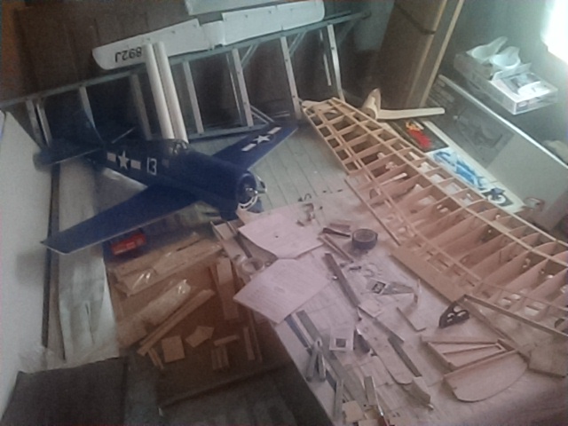

But here's a pic of my progress, had to revamp my work bench tho.

Looks to be progressing nicely

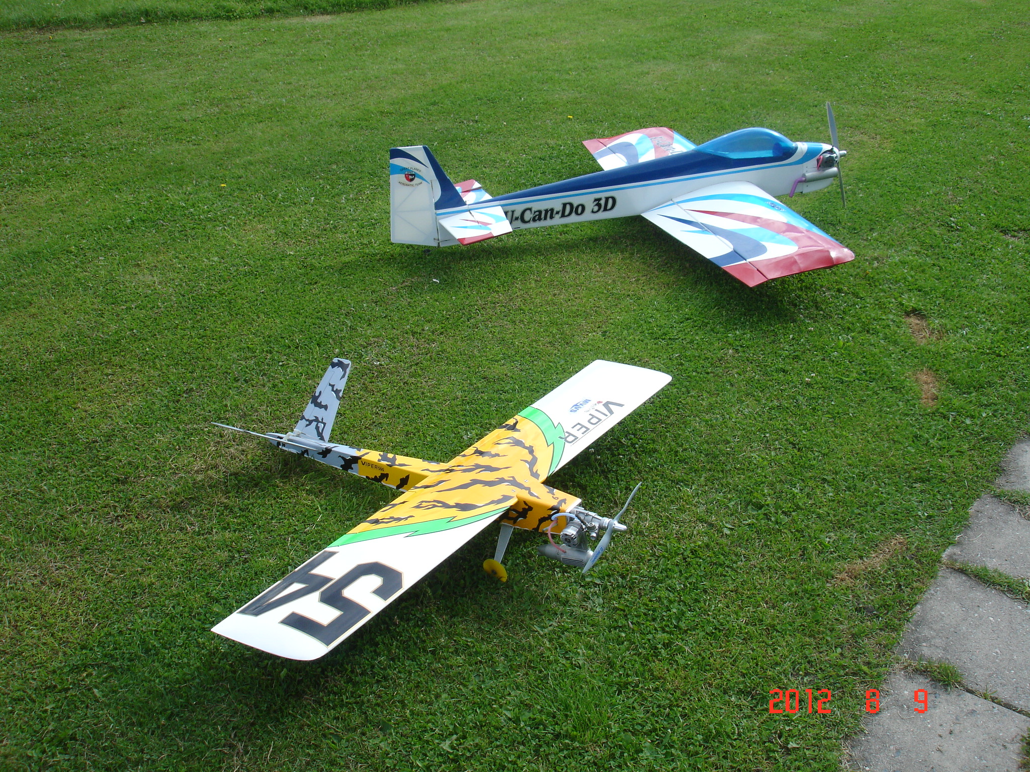

As most of the others have already said: Clipped wing will be worse because it will increase the wing loading which in turn makes the plane more prone to stall and landings will be more difficult.
A tip! Build it light! A light plane will always be more forgiving in flight. Its also vital that you build the wing with slight wash-out in the outer portion of the wing, this will increase the likely hood of surviving the first flights.
But...before you even try flying the spit, prepare yourself by flying more aerobatic planes first so you get used to faster more maneuverable planes then just a high winged trainer.

Well, thank you, & good Lord guys, I literally took a crash course (lol) in flying with this Cessna (Corvalis 350 foam jobbie) it's from flyzone, & it's awesome, crashed the hell outta it already, repaired & back in the air I go....Fun, but repitious side wind keeps crashing me, things happen too fast yet

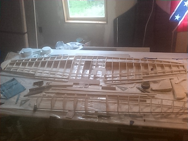

Hey guys, little more progress, I think I'm going to re-do the tail feathers, I do not like the slab side finish when it's to have a canvas over frame look, am I wrong?..& I'm going to take a couple different pics, sorry fellas' I only have a cracked cell phone to take pics with. And I'm about to build my cable system for rudder.. - do I also make 1 for the elevator, or use music wire?.. & as for lightening the bulkheads / formers....Leave @1/4" from attach point, from lightening hole, to attachment point? Correct? & Sorry if I'm confusing guys.

Spitfires shouldn't have a canvas over frame look. They were all aluminum. For the most realistic finish, you'd need to fully sheet the plane so none of the ribs or formers show.

Just a warning, some of the Spits had fabric covered control surfaces, some did not. If you're trying to model a specific mark of the Spit, you need to find out which way the control surfaces were made before covering them
