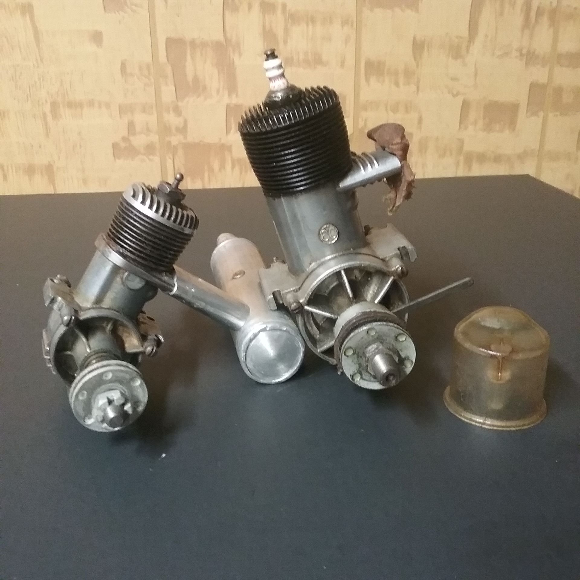

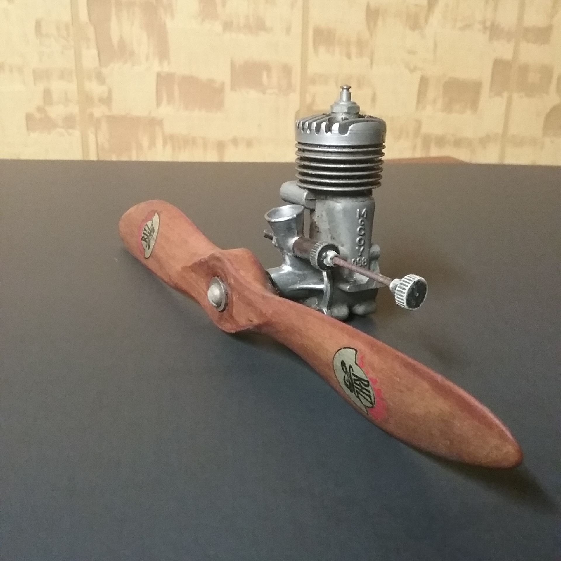

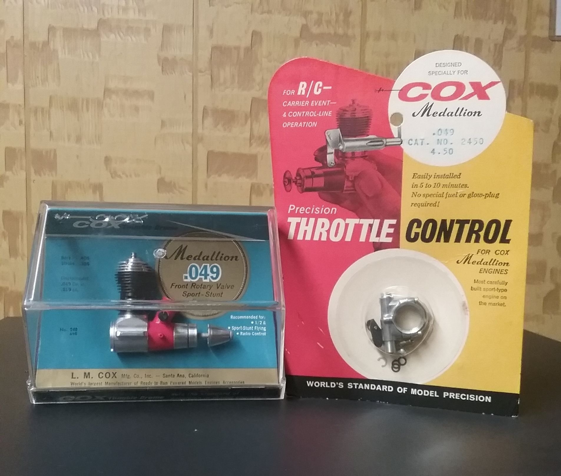

My neighbor's wife allowed me to save more stuff from the dumpster fate. I did notice a piece of mail from AMA in a box and through my investigations the local club requires membership for insurance purposes. I missed this months club meeting so I'll try to make it to the December meeting. I would not doubt my neighbor was known in the club.. After you read the following updated list he HAD to have been known by SOMEONE in that club! (LOL).

Engines
Saito
FA56 Golden Knight (NIB)
Mutunuc
65 ABC BB (NIB)
K&B
40 w/ Irvine Carb & muffler (NIB)
Veco 19 (NIB)
Cox
Medallion .049 (NIB)
Medallion .049
Throttle Control (NIB)
Thimble-Drome Pee Wee .020 (NIB)
O.S.
Max FP 40 w/muffler
MaxH 40P
Max II 15 (NIB)
Testor Corp
McCoy 19RC Blue Head Stunt Engine
McCoy 098
Cub
.074
49B
65360
Ohlsson Rice
60
? smaller than the 60
Norvel AME .061 R/C (NIB)
Enya 35 Model 5224
Atom ? Tiny Engine!
Quadra ? Big Engine!
Cer-Mag No.25
Arista-Craft No.1 (x2)
Victory Industries The Mighty Midget

Cox
Medallion .049
McCoy 098
Cub
.074
49B
65360
Cer-Mag No.25
