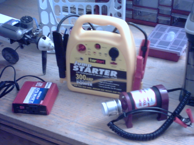

Once again thanks for the suggestions. I made my mind up and went with WCB's setup. The picture shows the Jump kit which also had a outlet like a cig lighter. This is good for charging my electric planes. I have the DC to AC Power Inverter for my radio and receiver so I can charge them in the field with the stock wall outlet plug in's, and of course the starter. I took everything out today and everything worked like a charm. You guys helped allot and I appreciate it.

If you notice the nose gear and the prop on my DURA Plane.... Well the wind was around 13mph today, and it made for some interesting flights and landings!

Doesn't that actually cost more than a battery?

It depends on the battery I supose. The way I looked at it is, its self contained, easy to carry, has the battery power level on board, has the cig outlet, and if I ever need a jump there it is.

flyingmonkey, i use one of those jump packs also. they work great, we usually clip 2 or 3 field boxes to one and we all have power to spare. I have also used a full size car battery. PITA to carry back and forth to my truck. For a whole flying season i used the car battery and never charged it once.

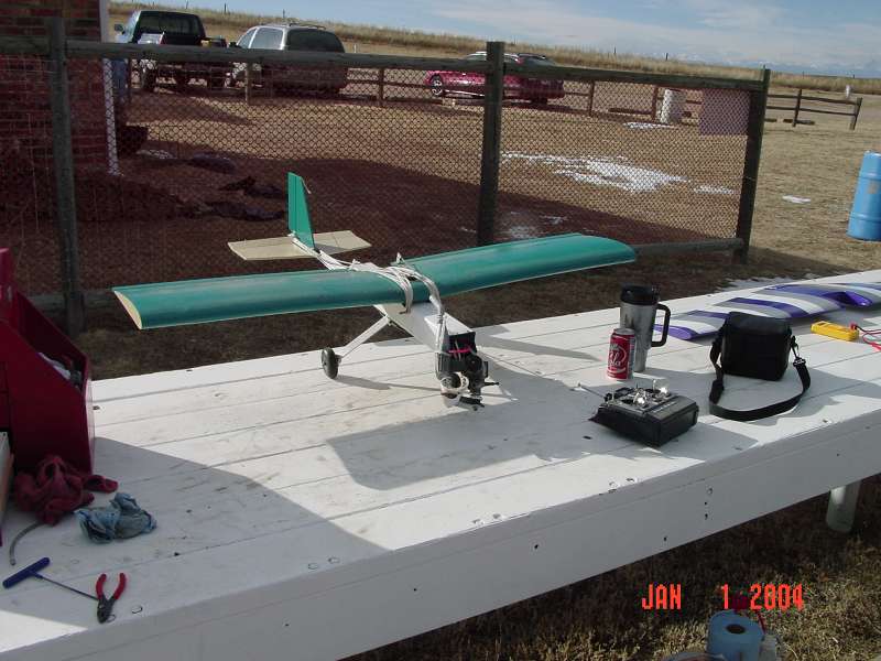

Hey monkey, check out the engine mount on my duraplane. I used it as a lawn dart a couple of week ago and you can see the engine hanging from the pushrod. If you need an engine mount for your duraplane, good luck. I tried to order one but it will be a few months before it gets in so in the meantime, I used doubled 1/2 in. basswood and a universal engine mount on it. I have not finished it yet so don't know how it will work but beats waiting that long to fix it.

Compare that Duraplane fuselage to the fuselage on a SPAD Debonair.
www.spadtothebone.com
The gutterpipe to replace the main plastic section is about $8 for 10 ft. (cheaper than $20 per for the Duraplane part...) There are several ways to do the replacement firewall at the SPAD website.
My favorite engine mount for the PVC downspout fuselage is what is used on the RA-Cores Gremlin. (Duraplane and SPAD are not the only ones using downspout fuselages... hmm.. ) See that kit at: www.racores.com (the engine mount is a 1/4 inch ply plate doubling the PVC, with a cutout for the engine. The engine bolts hold the ply in the PVC fuselage)

I think I saw a mount at my LHS. You must have really planted the Ms. Dura to bust her mount. LOL. If I do decide to dig a well with mine I think I will build the mount with ply. Let me know how it turns out.
