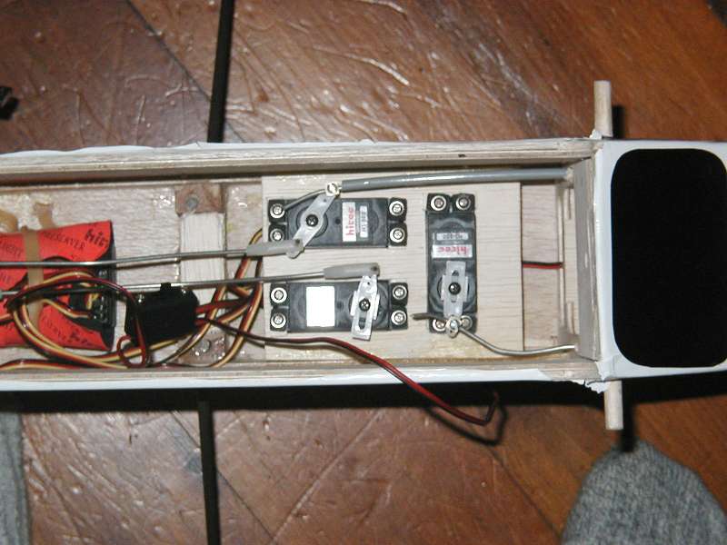

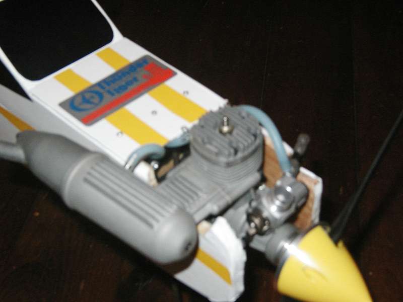

finally after 6 months of hard labor (work i mean) its done. today i put on the last peace and now its flight ready. how does it look.

Well... if that rudder servo is set for centered rudder... you have a serious problem. Same with the elevator (but QUITE not as bad)
The servo arms need to be perpendicular to the pushrod when the control surface is centered. to be offest 45 deg (like that rudder servo) would mean you get GREAT response one direction and essentially no response the other direction.
I hope the ailerons are set up evenly... if they aren't then I give the plane 1 flight to live.

if you look at the nose wheel in the 2 picture its turned the push rod is centered. It's like that with the elevator too

I see that your switch is not mounted to the fuse,
I hope you are not planning to put and remove the wing to turn it on/off.
One suggestion is to put that switch on the left side of the fuse with ON at the back. This way if you hit something in air your receiver have a chance of being ON. This is ofcourse if you hit something in air and survive.
Leaving the charge side out of the plane on left helps to measure the battery, you don't have to remove and put all the rubber bands every time.

I like the pattern you used for covering it, and the front hatch. that will make getting to the tank a lot easier, and you'll probably have to (I usually do).
I agree with Cobra about the switch. You don't want to have to pull the wing off between flights. If you mount it on the left side of the fuselage, it will also keep most of the fuel/oil residue out of it.

Looks very nice! But get that switch mounted (on the left side as the others said) and make sure there's no binging of those controls.

Great looking job, but I see one thing I'd fix. You're using one of those adjustable arms on elevator. Those arms are rather flimsy and flex easily. They work great for throttle and on light loads, but I personally woulnd't trust it on the elevator. Replace it with a regular arm.

today i got the switch mounted and the arm fixed thanks for all your help on this one.
