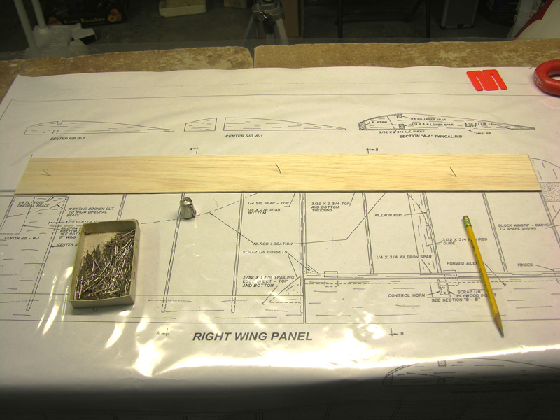

I am in the process of starting to build BaslsaUSA stick 40 plus from plan. The only thing that is holding me back is the rib template. The rib template can be seen in the attached file.I like to have flaps and ailerons on the wing and I would really appreciate if some could scan the rib template of Stick 40 plus plan for me and email them to me at [email protected]
