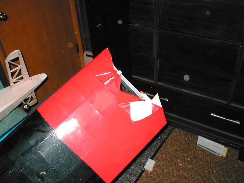

Well I finished building a Kadet Senior a LONG time ago, and I was fed up waiting for warmer weather, because no one would show up to the club to give me lessons. (you know where this is going)
So I loaded my plane up, went to the local high school, and started her up, and I took off. I pull up (a little to much I learn now!!!) and the plane went in a vertical. The little bit of wind took it and rolled it backwards sending it in another vertical. (Just the opposite direction. Towards the ground). And before I knew it, it nose planted in the ground.
So I have come to the conclusion, when you guys say NEVER to fly without lessons, your right.
Just had to prove that for myself.
Any rebuilding suggestions would be greatly appreciated

Ouch! Bummer, Flyin High.
On the up side, just about any damage to a Kadet can be fixed. A little CA and epoxy, and if you have all the broken bits, it's just another kit. Or, you can buy individual sheets from Sig, to replace missing stuff.
Hang in there. We're all rooting for ya.

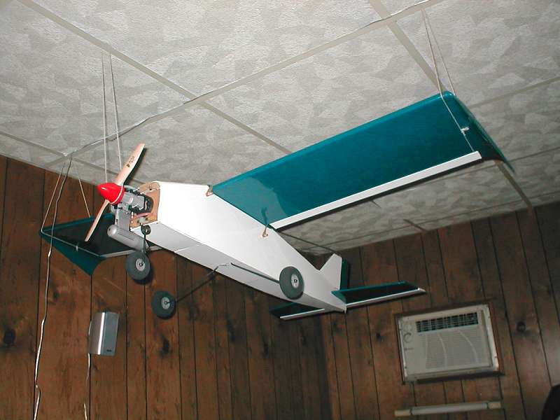

I know the feeling I was in the same boat. finished my senior this last winter. I built another trainer while waiting out winter but was dying to fly. This last weekend went out to the field and there were about 10 guys out. found a guy to take up my second plane and trim it out. The plane flew bueatifully. Didnt have a buddy box so we passed the tx unfortanatly I lost it and gave the tx back to the trainer to late to save the plane. After picking up the pieces,it was getting late and most of the guys were leaving including the trainer. But I still wanted to fly, so I got out my senior and decided I was just going to taxie it around unfortanatly a little too much throttle and the plane lifted off banked left over the pits hit the airsock pole and straight into the ground. Long story short it aint pretty but here are some pics.

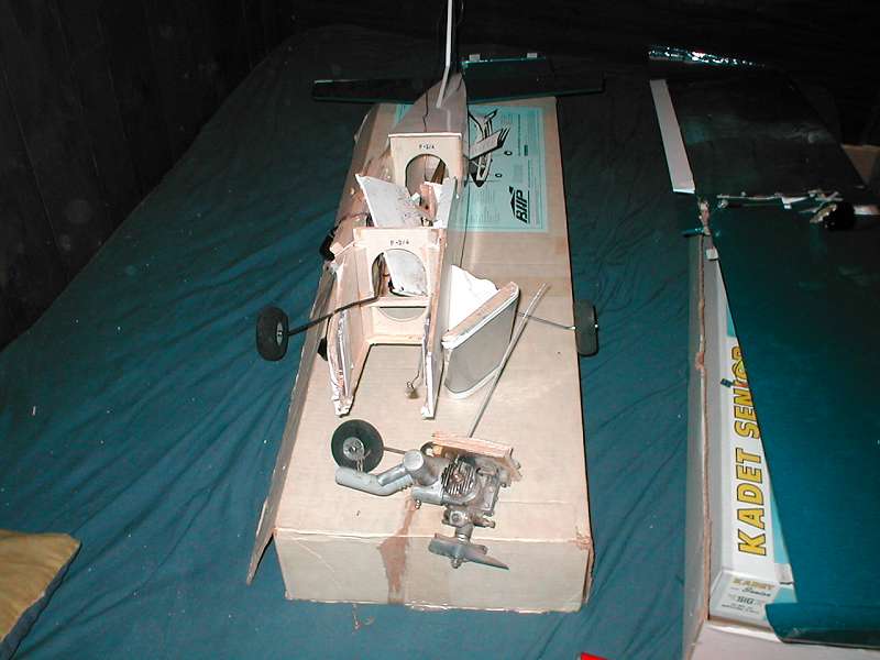

Well... they are repairable...[&:] (not easilly on the second..)
Welcome tothe toothpick club. I'm THE charter member.

for rebuildng the first fuselage... start by carefully fitting the 3D jigsaw puzzle together. When its all together.. CA it. then glue some 1/4X1/8 strips of balsa over the places that were broken. (I'd use yellow glue and clamp it well... )
Then patch up the covering... can either patch with more covering or with clear packing tape.
That should just about do it. You actually have MINOR damage. (I have field repaired worse than that cabin in under 30 min.)

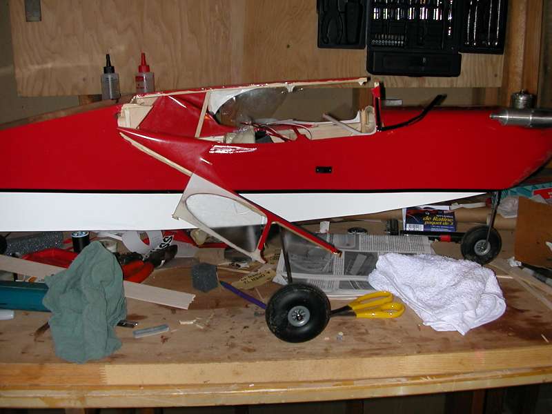

My senior is almost back together 2 nights fuse is ready to recover. Will fix the wing tomorrow night and covering will be in weds., should be complete weds. night or thurs. night. The other plane will be ready sat., I hope.
