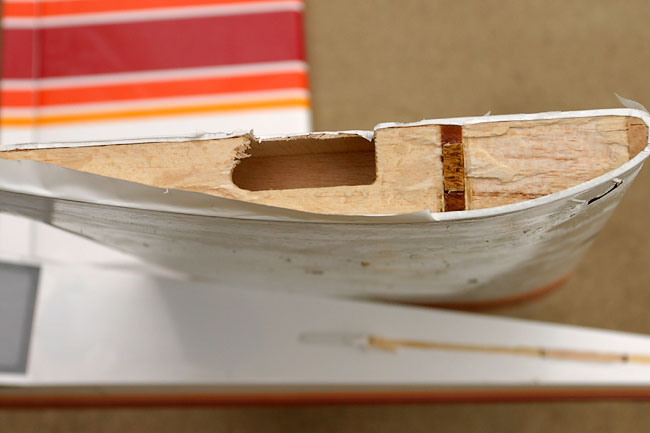

I crashed my Midwest Aerostar trainer today. I just started with RC planes. I've talked to a lot of the guys in my local club and read many posts on these forums before buying my trainer and gear.
This was the third day I had taken my plane out. I have a lot of experience on the Sim over the past 3 weeks, so I picked up flying the trainer pretty quickly. Yesterday I was doing rolls, Immelman's and loops. The members watching me yesterday said I was ready for my second plane.
I was out this morning and on my third flight of the day I was doing some similar maneuvers when I was coming around for another pass the wings (a one-piece that is rubberbanded on) snapped right in half. The plane, of course, came down like a brick into the tall weeds adjacent to the airfield.
When I came back to the pits with the pieces in hand, some of the regulars were like: "you flew it too hard for a trainer". Now they tell me. A day ago they were teaching me to do Immelman's and loops. I'm not mad at them at all though. I was the one flying. At least I'm ready to get a plane that can handle all that stuff... and a lot more.

doesnt look too bad, put acouple hours and acouple bucks in balsa and superglue and it could be flying again

Sorry to hear of your mis-fortune.. But it looks fixable!!...

Thats a classic wing failure. Probably used CA on the wing joint. Epoxy your next one....or that one if you want to rebuild it. And glass the wing joint as well. Its critical to do that.

If it looks like it was the fault of the manufacturer give them a call. If it wasn't one of your glue joints but one that the ARF builders did they should replace it if it's under warranty. I've heard of other ARF manufactures replacing planes with failed glue joints or no glue at all!

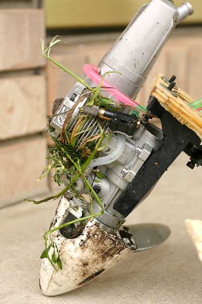

Split don't give up on the engine yet. It actually doesn't look bad. Clean the outside off. Do NOT turn the engine over. You could grind dirt into the engine parts. Remove the muffler, carburetor and backplate. Use some carb cleaner and flush the gunk out if there is any. Clean the carb out real good. Look in the exhaust port and see if there is any debris in there. If there is remove the cylinder head and flush it out. Make sure it is clean inside. Use some afterun oil and assemble it. Get a new prop and spinner. You should be able to run it then. I see it has a remote needle valve. Check it out thourougly for damage. You may need to replace the high speed needle. Clean it out and fix it up and you should be back on track with the engine. Good luck with it.
BTW the plane can be fixed fairly easily too. See if you can get some help. If you cannot get a replacement under warrenty I would fix it and continue on.

Why don't you try fixing your plane yourself? Don't get me wrong. I'm a newbie and wouldn't know where to start. But, I would ask the others at my club and find out how it is done - this kind of knowledge will come in useful in the future and it's better to practice on your trainer rather than your pride and joy aerobatic plane
I washed my engine out with water. Crtical thing is DONT TURN it! After you have washed it out you could take it apart to see of anything is bent inside etc. After you have washed it you can either run fuel through it or after run oil... to stop it rusting obviously.

I talked to the guy at the local hobby shop and he said he'd talk to the manufacturer since the wing spar broke, even when I used epoxy on both wing halves, in the slot where the spar goes and on the spar itself.
