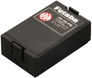

Some transmitters have "modules" that plug into the back. There are some that are a single channel, and some that can be switched from channel to channel. (Generally called a "synthesizer", or similar term.)
I would imagine that a local retailer could order a "module" for any transmitter that you bought, but I'd check first to see if modules are available in your frequency range. (They should be, but....)

Maelstrom:
--U.S. Federal Law has no bearing in Sweden, where the original post contributor lives....
--Your JR crystals are not the same as the module DBCherry is talking about (see attached pic). They plug into the back of certain radios and are self contained Tx modules.

Luis,
Gary's right. A module is completely different than a crystal, in that a module has all the "tuned" components contained inside. The FCC is not concerned with changing modules because it does not "detune" the transmitter.
