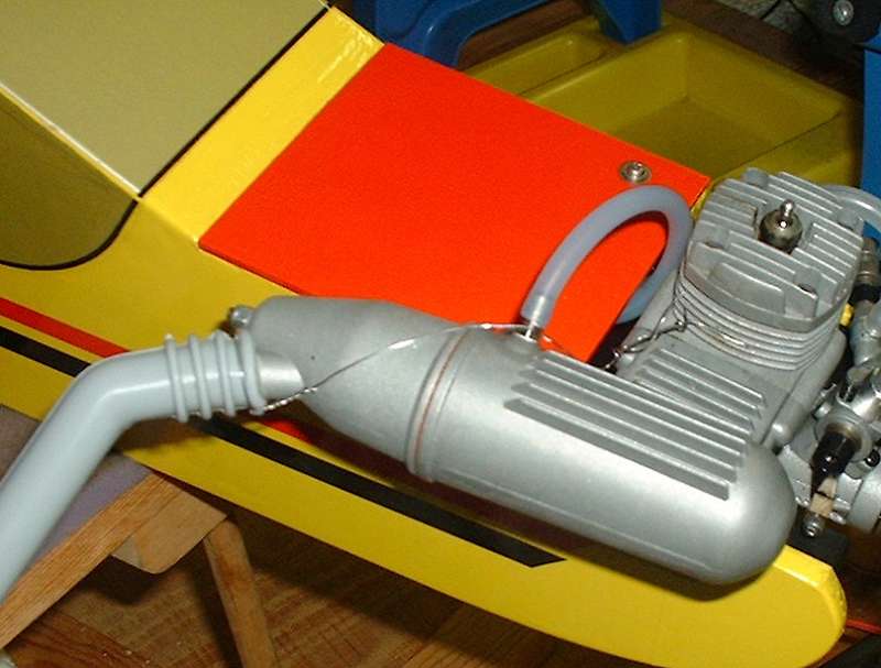

I also safety wire mine on, after the tie wraps failed a few times !! Usually in the field. never to be seen again ![] Haven't lost one since !
Ugo

Ugo could that wire around your engine cause metal to metal inteferance? i dont really know much about it just what i've read on these forums.

What is metal to metal interference? If your referring to dissimilar metal corrosion, I highly doubt it will play much of a factor that would be of any concern. If you choose to use the lock-wire method I would recommend a .020 - .032 monel type. (Monel= high heat resistant). I dont think it be necessary to wrap it around your engine though. I would attempt to limit it to the pipe/exhaust for anchoring.

If you're talking about radio interference.... None at all ! I wrap the safety wire (.032) around the engine to hold on to the Muffler assembly which it too has come off a time or two and has been hanging off the safety wire. At $20- $30 a piece, The wire is cheap insurance! I Swear this is true....Two Mufflers were lost in the grass this morning at the field !! One was off a OS.108. That's $35 bucks. Buddy !! Might not look to cool but at 100 feet who cares? Don't tell me that I'm not securing my mufflers correctly, I've try all the methods other than welding them in place ! LOL !

Yep metal to metal interferance is why you shouldn't use say a metal clevis to a metal throttle arm as the two pieces of metal vibrate together and can cause radio inteferance in some circumstances.
