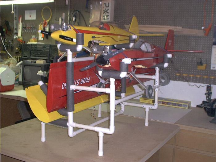

This is what I use. I screw the fittings to the pipe, so they are reusable if I need to make a different setup.

Old 07-01-2004 | 08:34 PM
Joined: Jul 2003
Posts: 1,483
From: coal township, PA
Default RE: Frame for carting around plane in back of pickup???
Pics are worth lotsa words> The PVC rack would have been my reccomendation. But just look at the pics and let your imagination roam.

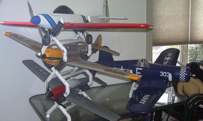

Hi, this is 15mm PVC . Fits in back of truck and doubles as a wall rack.
Have built to carry any two of my planes at once
Will take my trainer , 40 corsair , 60 extra in any combination of two!!
Sorry no pic in truck but you can see it sitting on floor as it does in truck.
My major design problem was keeping it below about 480mm so my cover would fit.
Worked out great,hope this helps
cheers torp

Hi Torp, I do like your ideas with the PVC and I think I will be using yours as my base frame with a couple mods here and there that I am thinking of.
My question is do you put it on the wood while in your truck so that it does not move around or was the wood just there when you took the photo? If you do use the wood how do you fasten the PVC to it?
I have to say I think I like the PVC method best.
Another question for you Torp... did you glue yours all together or is it so that you can take it apart when ever you need. I wonder this because I would not want it falling apart while hanging on the wall if not glued.

torp's Avatar
Joined: May 2003
Posts: 201
From: ashvegas, NEW ZEALAND
Hi, Steve CT .
It is all glued .When on wall just slips over a couple of brackets.If you look close you will see these.
Trainer moves up a notch when on wall to give more clearance to bench.
Plan well to suit future planes you have in mind.I have a TF60 corsair to
fit in here later.Will fit nice
When in truck it is screwed to the deck with 3, 10x11/2 self tappers.
Only takes a minute with battery drill.Sticks to deck good with the pipe insulation on the rack too.
Screws are good for roll overs !!!!!
No wood base used .Thats one of my plan boards.
My original prob was getting two birds to the field.This solved that.The wall storage was a bonus,just tryed it and it worked !!!!!!
Glad to help, torp.
