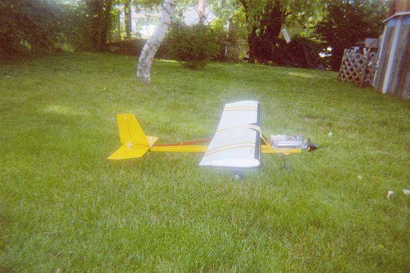

Here is mine.
I learned on it and still have it.

Thanks for the info but the picture looks like the updated version of the swizzle stick.
Mine is about 20 years old and it has a rounded rudder without ailerons. I dont h ave the plans anymore but if memory searves me right it had the option of barn door ailerons.
