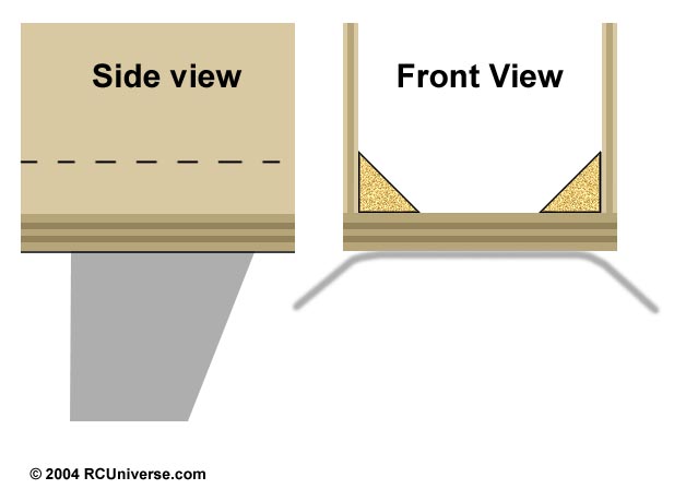

i have a small problem i read it on hear a little while ago and now i cant find the post to convert my plane to a tail dragger i have the landening gear and tail wheel just not sure how to go about it

Basically, you need to add a 1/4" plywood plate (about 1/2" wider front to back than the gear) and brace it with 1/8" ply on each side. Tri stock in the corners is a good idea too.
Place them so the wheels line up aprox with the LE of the wing
