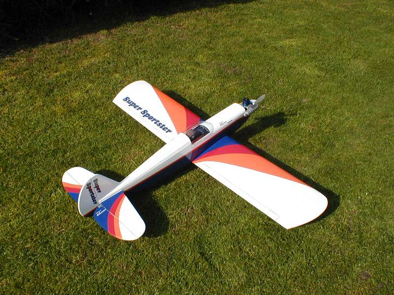

The GP SS is a great plane....... i hope this isnt your first plane............. mine went together fine it just needs some basic building skills as with all ART'Fs.......... remember to fuel proof the firewall and fuel tank bay before you install the engine...... as to screwing servo's down...... you are using the rubber grommets arnt you ???........ should be fine just dont screw them up too tight they dont need very very tight...... as if the wood is splitting it sounds like ur either not using the grommets or screwing up far too tight... as in the throttle what do you need to know ?
Pic of mines below....... althou ive now changed the landing gear onto the fuse as it didnt hold up too well on the wings
