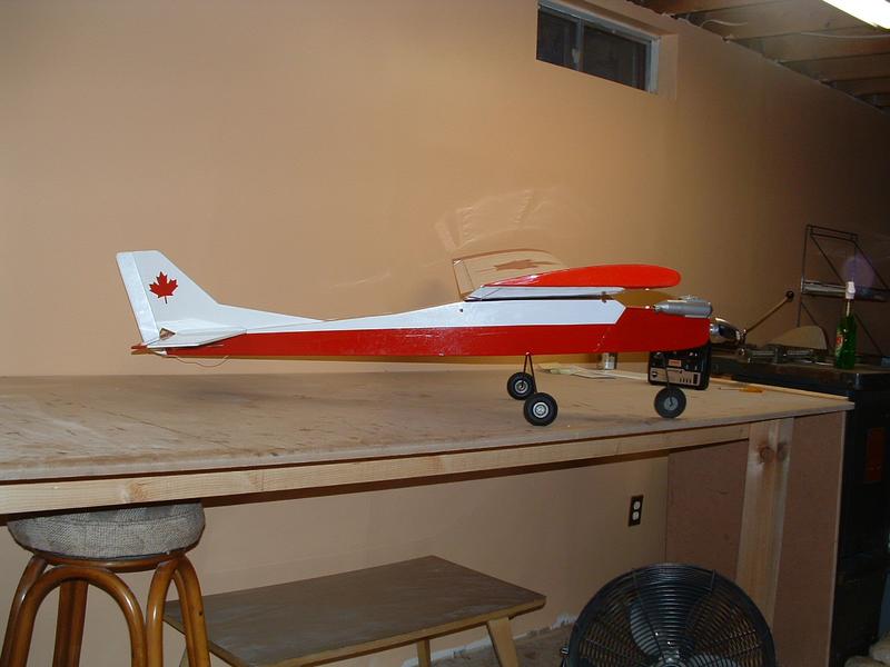

Yup ... been there, done that.
Here's my solution ... before and after.
The binding as not as much of a problem as the control-arm on the nose-gear bending and flexing so much. Also, taildraggers are actually just easier (off grass).
gus
gus
Make sure that there are no kinks or bends in the wire rod. Make sure that you don't have the guide tube crimped or kinked & that any bends are gentle. Lightly grease the wire rod with vaseline.
Better yet -- convert to a tail dragger.

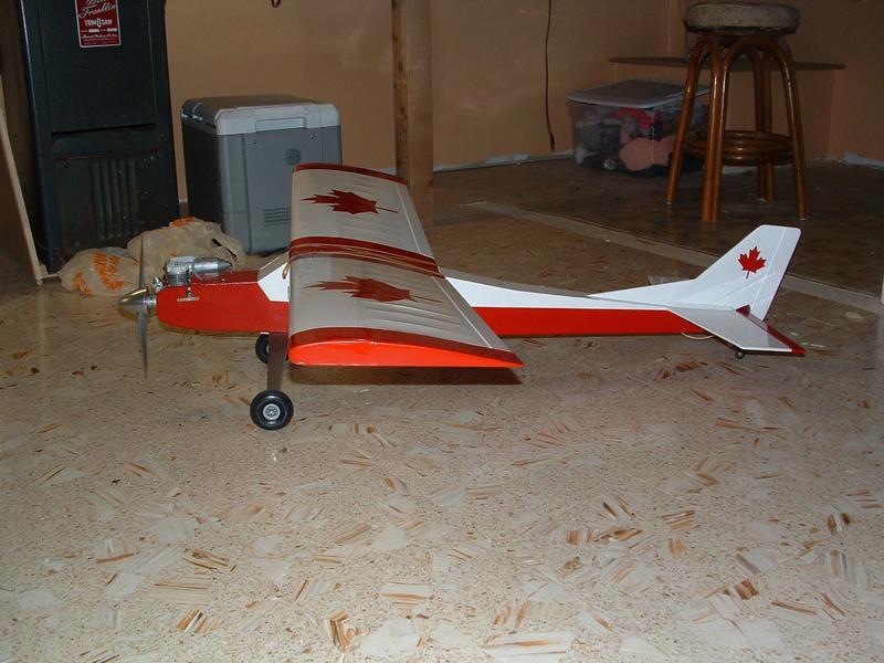

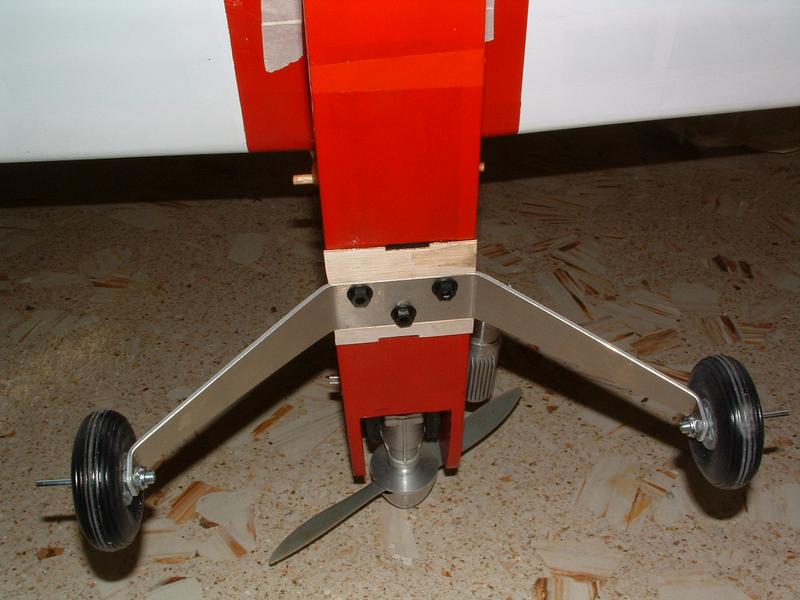

The main gear is (I believe) DuBro "Dural" .40 size gear. it was $14 canadian at the LHS. I got great planes axles, and 1/4-20 nylon bolts to mount the gear to the fuse.
I guessed that the gear should get mounted with the back-end of the gear in line with the former at the front of the wing. So, I pulled out the tank and used 6 pieces of 1/4" square bass-wood and jammed them up (with epoxy) against each other, and against the former. Thus, the fuse was re-inforced to take the gear. It was really fiddly to get the bass-wood in so that it fit snugly from the left-side "fuse doubler" to the right side "fuse doubler", hving to fit it all under the "tank floor". I imagine you can picture in your mind what I did.
Once the fuse was re-inforced I pushed a T-pin into the fuse so that it came up into the F2 Former (i.e. I found the back-end of the main gear). I lined up the gear using the T-pin as a back-stop, and marked where the gear mounting bolts would go. I drilled the holes and tapped them to 1/4-20. To make sure the gear doesn;t moove around too much I also added some lite-ply "gear guides". See the pics.

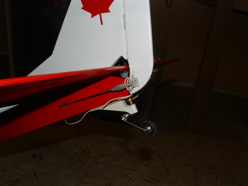

The tail-wheel was easy. See the pic. I used a sullivan .40 size tail wheel (first I cut the monocote, and re-inforced the bottom of the fuse with lite-ply).
gus
Nice looking job, but it was a lot of work. I have found that mounting the main gear bolt-down block on the floor of the fuse, tight against the back side of the former, works very well & you can easily get at that location from the open battery/servo bay. This puts the wheels just under the leading edge, which is a good location. If you get the wheels too far forward, the take-offs can get squirrely.

Nice conversion, now I have something to do this winter. What is the dimension of the gear width, as I will probably make a set at my shop out of T6.

I believe It was Great-Planes gear I used, not the Du-Bro.... not sure anymore.
I believe it was http://www2.towerhobbies.com/cgi-bin...?&I=LXJ922&P=0 They list the width as 10 3/4" I'll confirm later.
The ground handling is more than fine. Been up for at least 15 flights since conversion, and not one ground-loop or nose-over (flying off grass). I am very happy with handling. I think putting gear behind former would be too far back, even if it was easier to install.
The spring on the sullivan tail-wheel is just pushed up into the ridder with an appropriate bend to get around the curve of the rudder. Turning on the ground is just fine.
