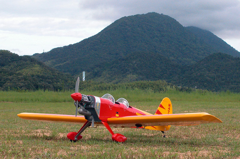

Hi from Japan to a fellow Orange County native! What field are you flying out of? I was with Corona RC for a while before returning to my job here in Japan.
As soon as I got here I bought the Seagull Spacewalker II and it is one BEAUTIFUL ARF and one TOUGH BIRD. I've crashed it 8 times (my faulty not its) and each time it was back for more in a couple of days. Last time I ripped out the firewall so it's going to take a bit of rebuilding but the wing, fuse, and tail are fine.
One thing though, this is a heavy model and it wants to fly fast compared with a trainer -- and I've only got a Magnum 40 on it.
Good luck!

I flew my Spacewalker II once with the wheel pants and then took them off to fit larger wheels (about 3 1/4"). As you can see I also left off the cowl -- both for looks and for easier access to the engine. The cowl is super well-made but I just didn't like the look of it with holes cut out for the cylinder head, muffler, and needle valve.
