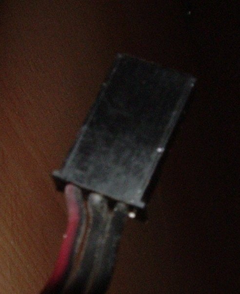

Okay, here is a pic of the airtronics connector. One red wire on the end. The other two wires look black though...not blue. Might be because of age.
Dave...

That's the old style and if you look close the outside black wire will have a grey/white trace on it. Probably real light but it will be there.
The new "Z" style is a blue connector. The adapters are readily available or just cut off the old and solder on new ends.
