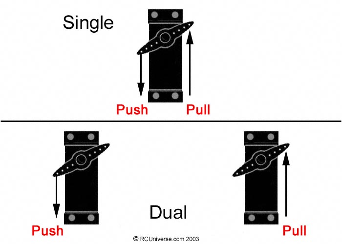

Was wondering if this is possible. Most glow aircraft have 2 servos for the wing, 1 for rudder, 1 for elevator and one for throttle.
Thus, you need an rx that has 6 channels if you count the connection you need for the rx battery.
I'm wondering if you have a hitec 555 rx, thats a 5 channel rx for all you newbs, could you use a "Y" connector on the battery and
also the left airleron to connect to the 5th channel slot on the 555 rx? Would this work? I'm trying to save myself from buying another
rx....

I have a Futaba 9C radio. I do have a couple of models where each aileron has its own servo. One servo goes into the first channel and the other aileron goes into the 5th channel. However, if you "Y" the two aileron servos, and put this connection into channel one of the rx, how are you going to get the ailerons to move correctly? Example....if I turn left, wouldn't both servos move the same way thus
making each aileron move up? Or, would you position the servos so that the servo arms move opposite?
Dave...

Yes to your question and your answer. If using a Y you'd need to set up the linkage properly to allow for this. But, you can also use a Y connector to plug the battery and and one servo into any channel on the receiver.

Let me expand on what DB said. Yes, both the servos move in the same direction. But you generally install wing servos either surface or on a plate. Surface mount, the servo arms would come off opposite sides of the servos. So when one arm moves foward, the other moves back. With plate mounted servos, they're generally mounted either facing each other or away from each other. Same deal as with surface mounts. The only time the servos would ever be mounted pointing in the same direction, or with the arms coming off the same side, would be for flaps. Sorry if this dosen't seem to make much sense. As soon as you look at an airplane with dual alieron servos it will fall into place.

Or, look at a wing with a single aileron servo. Each aileron torque rod is linked to one side of the servo arm. You could do the same thing with two servos in the center of the wing, side by side, turning the same way, just with a one-arm servo arm. Or, you could move the servos out to mid-span of the wing. Same story.
As long as the linkages are attached to the outboard side of the servo arm, and the servos turn the same way, the ailerons work as intended.

Here's a graphic example of what Dennis and Andy said:

Your statement of a typical wing having two servos usually doesn't require another channel. Just use a "Y" connector to connect both servos to the same channel, providing that the linkage is set up properly.
