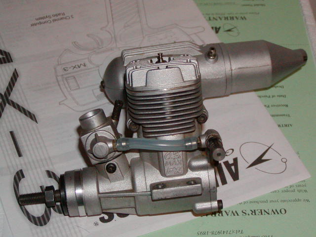

Check it out. O.s. .46fx!!!!! These aren't made anymore but parts are still avalible. Got it from my dads friend in trade for putting his Honda 250r three-wheeler together this spring. It was ran very little and has tones of compression. I can't wait to run it. What prop would you recomend????

Did he give you the manual? It should have some prop recommendations. In case you idn't get it, never fear. OS is really good about posting manuals on their web site. In fact, it's at this link: http://www.osengines.com/manuals/50s...1fx-manual.pdf
In case you haven't learned this yet, prop sizes tell you the diameter and pitch. The first number is diameter. The second number is the pitch. It tells you the number of inches the prop will move forward for each revolution. In general a prop with a smaller diameter but higher pitch will make a plane go faster than one with a larger diamater but smaller pitch. The reason I mention this is to suggest that as a beginner you want to choose a larger diameter, smaller pitch prop. This will be slower, but will actually pull the plane better. It's kind of like being in a lower gear on that 3 wheeler.

Computer radios are getting more features and cheaper all the time. If you go with anything fancier than a basic 4 channel radio, you won't be able to use the extra functions while you are training anyway. Then after you pass your wings you will still probably be just getting some practice in using the basic 4 channels. By the time that you are ready to move use another channel the newer radios out will have your original radio looking obsolete. MY 2 cents, keep things simple and get a 4 channel radio for starting out. It will work just fine and you can use it for other things down the road. I have 9 planes in my Hangar right now and don't have a computer radio. For your 46FX a Master Airscrew 11-5 prop will work well for a trainer.[8D]
