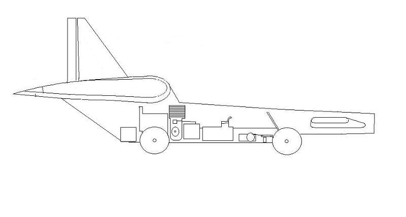

Alright here is the story. I am wicked into nitro rc cars and my buddy is wicked into rc planes. So I came up with the idea to put a set of wings on my nitro 1/10th scale truck.
First off I DONT expect this thing to really "fly” I just want it to glide to safety. Okay here is my plan. He (my buddy) has a lot of parts of an avastar trainer plane. We have lots of fabrication abilities as well. We where thinking that if we took the main wing, what ever you guys call that and put above the center of gravity on the car. Then we take a rear half of a plane and stick it off the back of the car.
To make the car "take off" I will drive my car full speed (50 mph no lies) off a jump. This will propel the car about 10 ft in the air. Not all that impressive. To add to that we will have the lunch off the top of a hill. So it has to land at the bottom of the hill.
My buddy will steer the plane once it is airborne and hopefully land it after about a 30 ft decent. There is no doubt in my mind that his abilities to fly will be an issue. He could fly book shelf if it had wings.
There is one problem (so far) my buddy isn’t convinced that it will simply glide and neither am I. The car is just over 2 lbs. He thinks it will drop like a rock once the tires leave the ground due to no propulsion. So he wants to put a second engine of some sort. I was thinking of a electric engine with a propeller on it mounted to the top of the plant. And have it mounted pointing to the rear of the vehicle to so it will push the car along once airborne.

while it's an interesting concept, there is absolutely nothing that makes it attractive. it's not going to be great plane and it's not a good car. it doesn't share any components. the only thing is maybe sharing the chassis/fuse.
if you really want to see this thing fly. take an avistar, add one pound of weight. fly it. if it flies fine, add another pound. if it still flies (it should since you'll only have about warbird wingloading then anyway) then take the avistar and strap it on the the car and drive it off the cliff. should work like a charm.
if you want to be sophisticated, then try to leverage components. for example, if you're running shaft driven car, try to add a pully to pull a prop rather than using an additional powerplant. better yet, instead of driving all four wheels, lift the front gear box higher and run a prop. if you're using a belt driving car, consider disengaging the front drive and routing that to a prop on top of the wing.
otherwise, string up a whole bunch of zip ties and just lash that car on the belly of the avistar... of course, watch out for the CG. i don't think it will be that hard.

The video is a Must! I like Forestrokes ideas on linking the cars powerplant to a prop. That would show some real creativity and novelty. Assuming that you can get the CoG right, I think you'll have problems getting to the ramp at top speed. 50MPH on an AviStar wing should develope a LOT of lift
A nitro 1/10 touring car weighs in at about 1.7 kgs, about 3.8 pounds. There is no way you can find a nitro car of 2 pounds! Even a NTC3 is over 1.5 kgs.
You will need a wing of about easily 52"-58" (bigger wing makes it easier to glide and you need not have so much power) with a chord of about 8"-10" to make this flyable. This is all just to keep it potentiall afloat. Now let's talk about powering the plane. The plane will need a nice big outrunner to turn a prop of about 16x8 at a minimum. Something like an AXI 4130 is a minimum. Now we will need batteries, say something like a pack of 5S2P. The electric motor and batteries will take your whole car-plane to about easily 8 pounds.

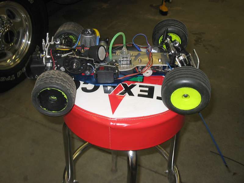

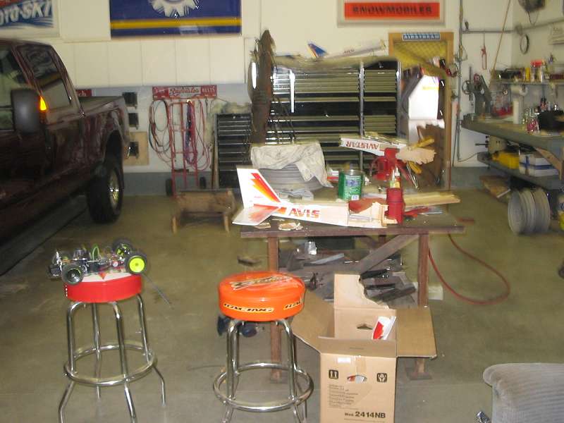

well I just got off the phone with my buddy. the conversation was brief because he is at work. we concluded that we are going to first "glide" it off a hill. then we are going to learn lots for that and go from there. He was against the adear of taking a plane and straping a car to the bottom of it becuse then he would have to buy a plane.
Here are some pics of what I am glueing up now........ there is also one of the jump I slaped together. and a pic of the car that is going to be used. I am probly going to shed some weight off the car before it flys.

at 5 lbs you're not going to be able to get much of a glide. the plane sans engine will be 4 lbs... that's a wing loading of 34 oz/sqft which means you'll pretty much have a glide ratio of a cow. plus with 9 lbs on the wings, they will likely collapse under the weight (or rather over it).
and so much for propulsion, that car doesn't have 4-wheel drive and the engine is transversely mounted. will be near impossible to get that to a prop without significant cost and additional weight.
and... saw the avistar fuselage (remains) but didn't see the wing.
from the looks of it, it will be a very difficult project due to the center of gravity of the car being just forward the engine. don't know how you would be able to get all the wings etc mounted. you'd essentially have to build a new frame above the car and hope the engine doesn't burn through it.
the better solution would be to make this a canard meaning that the main wing is in the back rather than in the front and the elevator is in the front. this way the CG needs to be 1/3 the distance from main wing to the stab which means that the car fits right in.
