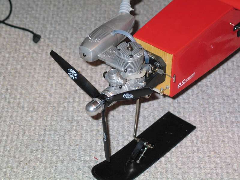

I have an .46AX and it is reliable and powerful. Best bang for the buck as far as .46's go. I had a crash with my Big Stik and broke off the needle valve. Does anyone know where I can get a replacement or if some other needle valve will work with it?

Best I could find was complete valve assy. os does not list just the needle.
In fact the Tower pg below states the needle is not available as a separate item. If you use different needle, you will probably compromise tuning, your choice.
http://www2.towerhobbies.com/cgi-bin...00&FVPROFIL=++
$18
if you need bracket, here it is:
http://www2.towerhobbies.com/cgi-bin...?&I=LXGCV2&P=V
Good luck.

Thank you for your effort. After writing the post I went to tower's site and found it. I ordered one today.

HEY i wanted a prop like that !!! what sixe is it ?

You will get more power and generate more thrust from a 2 blade prop than a 3. My experience tells me that APC props are better than MAS.
Generally you would go down an inch in dia. when moving to a 3 blade. e.g. 11x6 (2 blade)=10x6 (3 blade).

and they dont even make 10x6 3 blade [&o]

Don't know which "they" you are referring to. Try this if you want :
http://www2.towerhobbies.com/cgi-bin...23&FVPROFIL=++
Yes, not MAS or APC but still 10x6 3 blade

OK. duh...Sorry. It is an Master Airscrew and you are probably right. I think it's an 9x7 or 8. I will double check it and ring back in with an answer. The reason I bought it was to provide additional clearance for the front ski with the trike gear. With the 11x6 props installed I hit a couple of bumps that caused the front ski to rotate too far forward (even with set screws super tight) and broke a couple of props. The shorter 3 blade corrected this problem but reduced thrust significantly.
