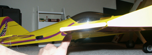

Ok,
I have another stupid question...
What would the neutral position be for the twist ailerons ?
Do I want the aileron to be parallel to the fuse.. or should the aileron follow the wing contour
to be in neutral position ?

Take a ruler or straight edge and go from the center of the leading edge to the middle of the trailing edge with the aileron parallel to that line.

delman hit it right on the head. This will show you exactly where the aileron should be located at in the center location. Take a look at this picture, hope it helps
