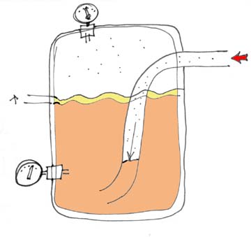

The example of a person blowing into a tube while swimming deep in water is a nice argument for your case because everyone can relate to the fact that, as one goes deeper, one has to blow harder to get any bubbles to emerge.
However, bubbles or not, the over-pressure (that above atmospheric) is still transmitted to the fluid according to Pascal‘s law.
In the case of a model engine, running under prescribed conditions, rpm, etc. the pressure tap in the exhaust will have a given amount of over-pressure, no matter where the other end of the tube ends up. If this is, say 2 pounds at the muffler, it will be essentially 2 pounds on the other end of the tube. If 2 pounds is not enough to make bubbles in a deep tank of fuel, this doesn’t mean that the 2 pounds of pressure just disappears or goes somewhere else. It is still transmitted into the system. The air in the tube, and the fluid in the tank still transmit this pressure along. Of course it adds to the pressure in the bottom of the tank caused by the fluid “head†of pressure. This is a classic example of Pascal’s law which
I would suggest reviewing at the following link. http://www.engineersedge.com/fluid_flow/pascals_law.htm
The nice thing about this web page is it shows the pressure effect (equal on all surfaces) and shows how it combines with the pressure head effect.
To help visualize your example, here's my sketch of the situation you have described, where the over-pressure in the tube is fixed at a limited amount and insufficient to force a "bubble" into the fluid. Still it manages to displace some of the fluid in the tube, forcing the top surface of the fluid to rise, transferring the pressure to the air in the top of the sealed container. This pressure transfer is instant, complete and absolutely one-to-one. The pressure measured by the gauge at the top of the tank will MATCH the pressure at the input tube (at the RED arrow). The pressure measured by the gauge near the bottom of the tank will match the internal air pressure from above PLUS the fluid pressure caused by the "head" of fluid (it will be higher than the internal air pressure by the amount caused by the pressure head of fluid).

Time to eat crow.
After reviewing all the posts and websites mentioned in this thread, I have decided to reverse my position on the uniflow tank. I now believe it to work as described in Nigel Frasier Ker's website. My apologies to Nigel. He was right, I was wrong.
_______
Now before anybody starts to gloat, let me bring you down to earth (a little). First of all, Nigel's site is not so well illustrated and it requires very close reading to truly grasp what he is saying as being true. It was only thanks to another site, referred to by Jim Thomerson that I was able to understand the physics properly. Of course then Nigel's site became understandable. This doesn't get me off the hook but I wish his graphics had included the excellent diagram from the other site which I shall attach herein for you all.
There are two forces involved in the tank. One is the pressure head force which varies with the depth of the fluid above the carb clunk. The other is the gas pressure provided by the muffler tap (and ambient atmospheric pressure).
MOST of the proponents of uniflow argued that the gas pressure from the muffler is reduced or eliminated by the depth of the pressure clunk under the fluid surface - and this is what makes the fuel flow more even - and that, as the fuel level drops, the muffler pressure transmitted is increased.
I argued that the gas pressure from the muffler tap was transmitted immediately throughout the tank with no losses.
I was right in this.
Where I was grossly wrong was in failing to understand that the two clunk locations (at the exact same depth) eliminates ANY pressure head forces, leaving only the gas pressures to act within the tank. We were arguing about the wrong forces.
Please look at the diagram and see how the "head" of pressure is NOT measured from the water surface. Now envision the vent tube being extended down a bit, to the same height as the outlet.
I hope you have all enjoyed this...

One comment on the original diagram. I would cut the uniflow line about an inch shorter than the fuel pickup line. Fuel is being sucked (I know it is not being sucked, but cut me a little slack here) out the fuel pick up and it is possible that bubbles can be sucked out of the uniflow if it is too close.
