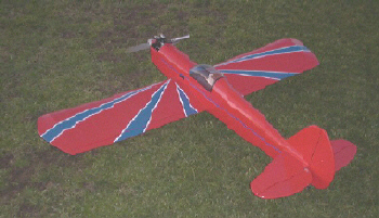

Old 09-27-2002 | 12:02 PM
Posts: 329
From: Lynden, AL
Default BTW...........
I had a 120 size super sportster I put the 150 saito on, flew awesome, the 150 would hover it no prob. (11 pound plane)
I cant imagine a SS without a 4 stroke.

Old 09-27-2002 | 12:08 PM
Posts: 329
From: Lynden, AL
Default one more
this plane is made for a four stroke.
Old 09-27-2002 | 12:13 PM
Posts: 329
From: Lynden, AL
Default oops
got the avatar pic instead
