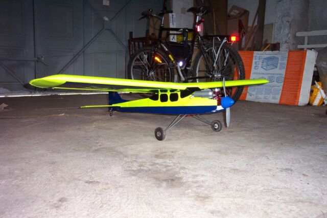

Hey Stedge 2000
I have a Nova 40 and fly in the Nottingham area. It is a pretty good flying plane, that has taken allot of abuse from me over the past 6 months.
Couple things ... the landing gear is pitiful. I ended up replacing mine with a pretty sturdy double wire mounted main gear, and changed it over to a tail dragger. Two main reasons, first the mains would bend up every landing (finally broke) and I had a real hard time with the nosewheel steering. It was way to sensitive for me, and I had a hard time controlling it.
Also, get some triangle stock and rebrace the firewall and fuel tank braces. I also rebraced the floor area around the gear mounts. I have had some pretty tough landings with this bird, and have busted allot of the bracing out.
So definately take the advice on spend good quality time on the ground with it before you even think about taking off.
As for help ... come up and fly with us for a day and we will get you sorted out. Good folks and instructors at our club. You do have to join the BMFA before you come and play though. Give me a post and I can give you directions and contact points if you are interested. Trust me, it is worth it.
Here is a picture of my Nova that shows the landing gear and tail setup.
Good luck ... Bo

Stedge .... here are a couple of more picutes of my Nova. First, I need to mention the reason for the covering change from yours is the five times this poor baby has met terra firma in an unkind way.
Second, yes the BMFA is the british equivalent to the AMA. That is the registration and insurance that you need to fly.
Third, on the build. If using a tail wheel, the main wheels need to be located so they are even with the leading edge of the wing. I installed a piece of plywood in the floor of the plane to mount the landing gear in their new position. The tailwheel is simply installed on the end of the plane with a rod epoxy'd into the rudder for steerage.
I definately recommend that you do allot of bracing on this plane. Every suspected weak spot on this plane has broken for me including the mount points for the wing, main and nose gear, firewall and fuel tank. I have also completely broken the tail off, and the nose (twice).
Shoom ... you give me much more credit than is deserved. The canopy stuff is just covering cut out in the shape of the windshield and ironed on.
Here is a shot showing the relationship of the mains and the wing.
