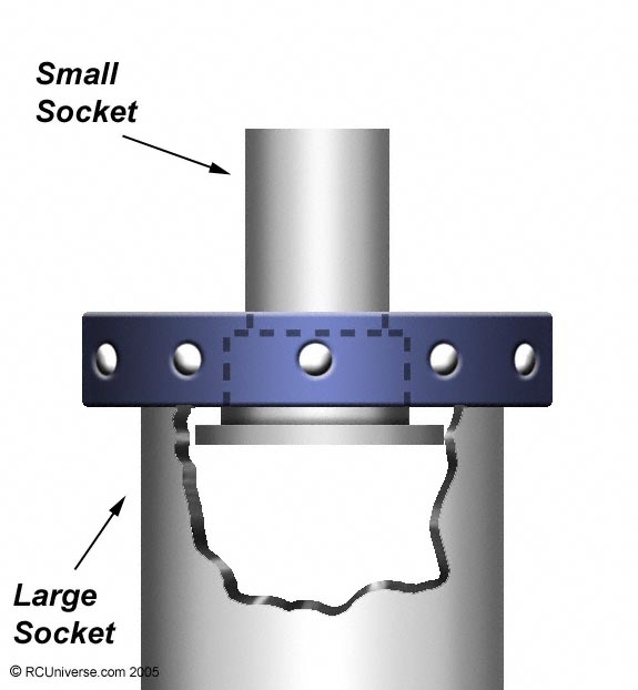

a year ago i purchased an alpha 60 trainer and its been a great plane to fly,now i'm wanting to pick up a little more speed ,so i was wondering if i could remove the training prop and install a larger one.the trainer .61nt has a fly wheel on it and the non-trainer .61nt does not. what can i do?

You can also remove the weighted hub by placing it over an open Vise, or a large socket (Large enough for the thrust plate to fall into). Then place a small socket on top of the back-side of the thrust plate and hit it with a hammer.
The thrust plate will slide out with a bit of persuasion.

Yes, the Evo will work fine with a 2-blade prop, and if the spinner you buy has a flat backplate, you won't have to remove the flywheel. I was just pointing out that if you DO need to remove the flywheel, it's possible, and very easy to do.
