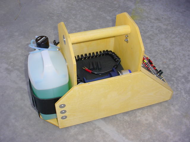

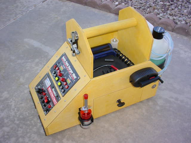

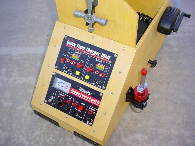

Here is the field box I have built recently. Its made from 6ply wood and stained yellow. Plan to keep it for life. A bit on the heavy side but its OK.
