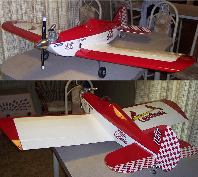

Yes, the windex method and trim solvent are similar in the fact that they activate the adhesive on the back of the monokote. I don't use trim solvent when doing the covering. I put on patterns and trim pieces by using the windex method, then after it has dried and set I go over the edges of the pattern with a trim iron (or a covering iron turned down a little) to seal down the edges. This has worked really well for me.
Here are some pictures of covering I've applied using the windex method and sealing the edges.
Hope this helps.
Ken

I have a little trick for the checkerboards. If you look at them closely (on the tail feathers of the Slow Poke) you'll notice that the white squares actually are connected together. This was done by cutting the checkerboard in white monokote and laying it over the red. I've attached a copy of the pattern for you. Resize the graphic so the squares are the size you want. Then print it out, and cut out the boxes that aren't connected. To transfer it to your monokote turn over the monokote and trace the pattern to the back of the monokote. Then cut it out on the monokote. Remove the backing and use the windex method to apply it.
Hope this helps
Ken

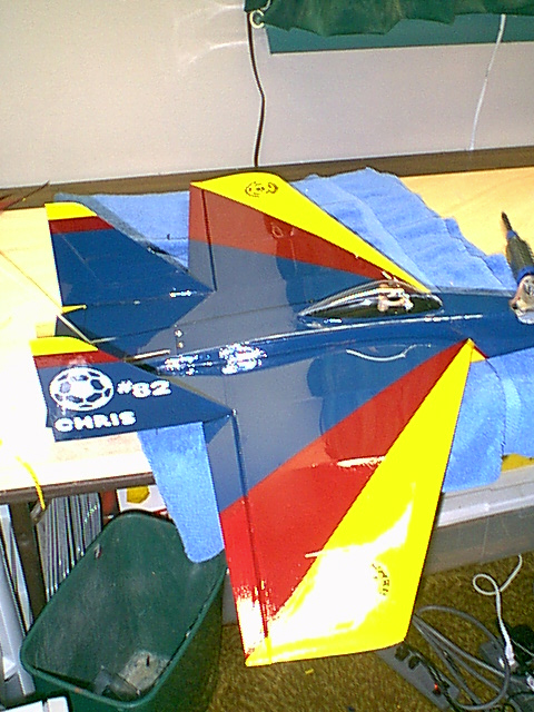

Just a quick comment. The Four Star line uses ultracote so using the windex method won't work without a little heat. I have the RED 4*60 and added 1 bay wide Yellow stripes to the wing bottom and a long yellow stripe from nose to tail. Some other stripes were also added to make it easier to determine the orientation. I used the windex method to place the stripes, then used a squeegee to take out all of the bubbles, then applied a little heat with a covering iron. This was my first time using the windex method with covering. If it did it over again, I would choose to use trim sheets that already have the adhesive on them. I will attach a picture of my 4* with the striping on the wing after I get home this afternoon from work.
