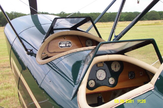

I did think about running my old one without a canopy. Never fell throught with carrying out it.

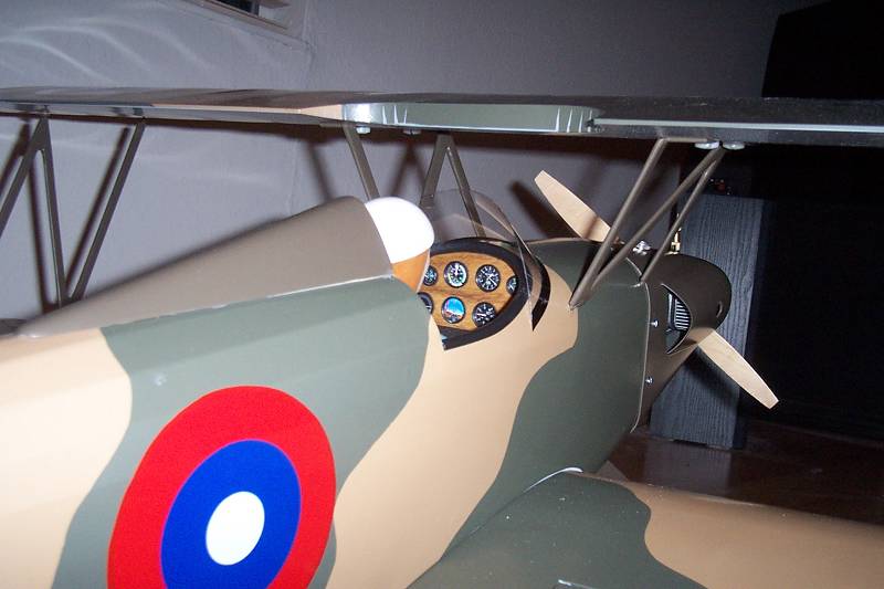

I cant top cwrr's photo, but here's my Sig Miniplane's cockpit with a simple plastic windscreen, attached right to the Monokote with RC-56.
