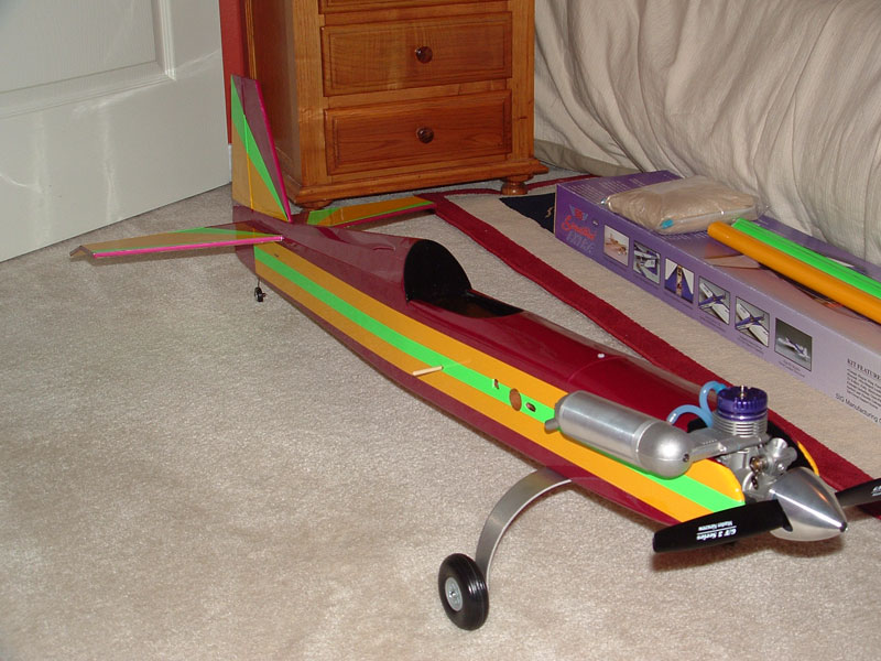

So, I decided to do a little work on her today. I have glued all the control surface hinges, installed main and tail gear, installed the engine mounts, mounted the engine, removed the fuel tank and altered it so I can access it in the future, re-installed the fuel tank, and altered the nose cheeks to give better spacing around the high end needle.
The only thing I seem to be missing is the way you make the spinner attach to the engine shaft.... I seem to be missing a part that would let the spinner bolt attach. If anyone knows what that might be called, let me know so I don't sound like a dolt when I go to the LHS tomorrow to get one.

I think you can just call it a spinner nut. Some might call it a spinner adapter, but that's what I usually call the little rings that center the backplate over the prop shaft.

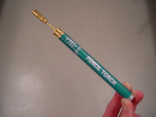

A small pencil torch and a Sta-Brite silver solder kit will make very short work of the soldering. I found the torch at my local hardware store for $3 and it's refillable with canned butane used for lighters. You just clean the parts with scotch-brite/steel wool, put a drop of liquid flux on the parts, assemble the parts and secure in position, touch the flame to the joint area untill it's hot enough to melt the solder. When the solder melts, it will flow into the joint all the way through. Let it cool and wash the flux off. You can then use the scotch-brite/steel wool to polish up the joint. I'll see if I can get a pic of my torch posted shortly.
OK - Here's the torch.

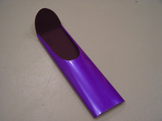

Here's my covering progress - it's not much, but it's a start. I'm sure the purple film looks a lot more blue in the photo. Maybe I can get something in the sunlight if the new work schedule permits.

That looks a lot smoother than mine did. How much practice have you had at covering?

My "Tigger 2" is the only thing I've covered previously. I think the difference is in using Ultracote. It shrinks/stretches a LOT better and at lower temperatures than Monokote, so it's much easier to work around compound curves. I have about 2 hours in the hatch cover, so it's not a fast process by any means. I was really impressed with the color - it was pretty neat in the plastic, but it's much nicer unwrapped. It should look really flashy with the white and neon orange.
