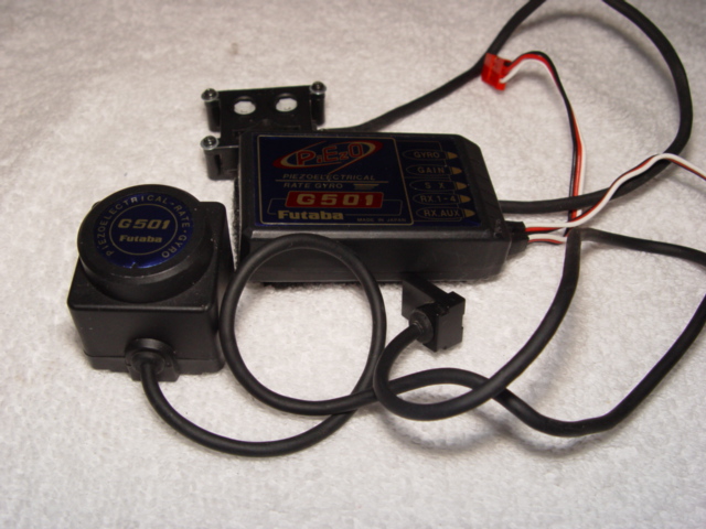

Avistar, putting a gyro in a plank (on rudder) is something I've wanted to try for a long time. And I just happen to have two mechanical and one piezo gyros, all in good working order, in the junk box...[8D]
You guys that have them; how big is the radio compatment in this airplane? I would need to squeeze in the three components pictured below...
