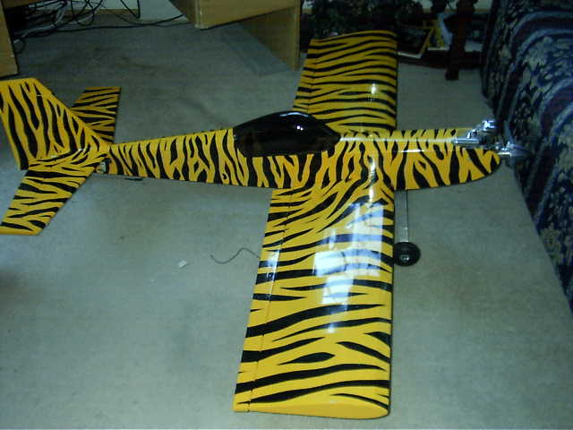

looks real good , as far as gluing with wood glue after you've CA'd in place. Note: The ca will wick into surrounding wood and seal it as I'm sure you can see. That will eliminate the use of wood glue in those area's as it will not wick into the wood and will dry on the surface. I use a drop of med ca in these ares's PS. I just finished my 4* 60 last week, here's a pic

THAT's gonna be tough to find in the weeds

I live in the NW. Everything's green
