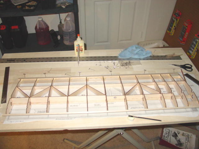

I got a chance to start building tonight and thought I would spend a few minutes preparing and so forth. That was around 7:00pm or so. I turned around a few minutes later and it was 11:00pm. I could not believe that I had been building that long.
I had to tear myself away so I wont be fighting to keep my head up at work in the morning.
Well here is what I have so far.
Dbow
Dbow

what direction is the grain on those shear webs going? something doesnt look right.
Just to clarify the grain of the shear webs should be vertical (perpendicular to the spar)

SIG kits like that come with pre-cut shear webs, so it's difficult to get them going the wrong way. How the heck could you tell from a picture like that, anyway? You gotta get closer to see the grain.
Wood glue is fine, especially for a first kit. Lots of time to reposition, think, and double-check. Not only that, it sands easily, which can't be said for CA.
BTW, dbow, the wing is looking nice! :thumbup:

you can plainly see a dark streak along many of the webs which would indicate the grain direction.
Also clicking on the pictures makes them bigger if you did not know
I think the dark streak you're seeing is the joint between the web and the lower spar.
In any case, This is what cracks me up about non-builders. They seem to think that building is a chore. Sure it can get frustrating at times, but then, so can a lot of things (women come to mind LOL). Building, for the most part is relaxing, rewarding, and FUN!
Note: I am not refering to people who don't have time to build, or can't build for other reasons other than they are unwilling to try. So let's not turn this into an ARF vs Building debate. Thankyou.

I used Thin CA to glue all the joints, the trailing edge sheet and the leading edge are the only places that have wood glue as added strength so far. I had already put the CA back on the shelf when I took the picture, so thats whay you only see the wood glue on the table.
The instructions say to go back and re-glue all joints with CA or Medium CA before sheeting. It also states to not be stingy with the glue.
I was thinking about going back and using wood glue on all the joints.
Is this a bad idea?
Should I just stick with the CA?
As for the grain direction, To be honest I have no idea what you could be seeing that leads you to think something is wrong. I went back and double checked it and I cant see any other way of doing it other than the way it is.
It appears to match up perfectly with the directions and the pieces are already laser cut.
Now Im not saying that its not possible for me to screw it up...lol
But so far I think I have built it according to the directions.

What about the Glue? Wood or CA to go back over the joints?
Dbow
Is this a bad idea?

Use wood glue or MEDIUM CA to go over the joints. Not THIN! Thin CA works on a capillary principle. That means it needs two (or more) pieces firmly pressed together that it can "wick" into. If the area is already glued, it is sealed off and the thin CA has nowhere to soak into.

To Kallikrates,
The shear webs in the 4*60 and the LT-25 are in fact designed with the grain running spanwise. While it is true that most models have shear webs that have verticle grain, this is more for the builders convenience in slicing webs from the end of a long balsa plank.
The four star 60's wing is about as stiff as a 2X12 plank of the same length. Between the one peice shear webs and the geodetic cross-ribs, it is one solid wing.
Posts: 158
From: gainesville, FL,
Thanks for the clarity I may need glasses but I'm not blind,
but yes every plane I've ever seen and built mysel has had virtical webs.
But, I guess you never hear stories of sig four star wings blowing up in midair so I guess their enginering is sound, and the diagonal ribs most likely strengthen the wing quite a bit.
anyways
I just questioned it because it's an unfamiliar building method to someone who's put quite a few kits under his belt i have never built a fourstar and was just worried for dbow.
anyways
