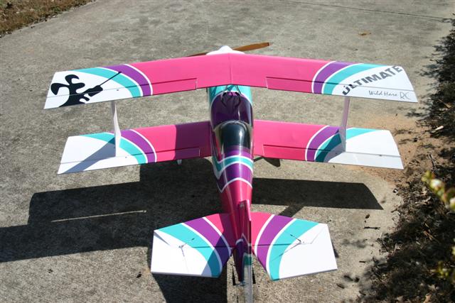

I'm gonna side with Ken here a little bit. The plane you are building is one of the best there is for a trainer. It's been around for years and you'll probably see that most other trainers were modeled after the LT-40 and for good reason.
Now because you are thinking electrics, I'll add my .02 cents in here. Electrics are not much safer than glow to a point. I have 2 very large scars on my right arm to prove it. I hit the power on one with the throttle reversed in the radio and it jumped backwards and before I knew it....
But I will say this...there is nothing wrong with getting in a little practice before you fly your nice new plane. I'm sure I'd want to do the same thing if I was building my first kit before I was done training. Parkzone makes really cheap nice flying simple electric planes for under 200 buck complete, They are great for times like this when the days are getting shorter and you have a good sized parking lot at work!!!
And yes as is custom for me, here is another example for ya....
Most everyone that knows me knows I love big planes with gas engines (not glow). Most everyone that knows me knows I own a well flown 4*60. Allot of people use this plane as a primary trainer as well as a first low wing plane. I find that flying the 4* gives me the freedom to not worry about planting a high dollar plane and if I ever do crunch the 4* I feel it owes me nothing as it has well over 200 flights and literally lives in the back of my truck, except for right now since I got my Cap and Showtime ready.
All I'm saying is most people at the field won't care what you are flying. It's the ones that say, you should do this, fly that because it look better and yada yada yada that I stay away from.
My 4* is by no means a looker and I have been told I should recover it and stuff BUT I let some of those very same people fly it and they usually never say another word about it other than it flies great and they want one too. So see, there is nothing wrong with having a trainer. I still have my original LT-40 for trainer races at the clubs flyin's. My guess is after you move onto your third or fourth plane, you might start teaching others to fly and once you have to fly a trainer for a student you'll remember just how much fun they can be and go get another. Most people do...

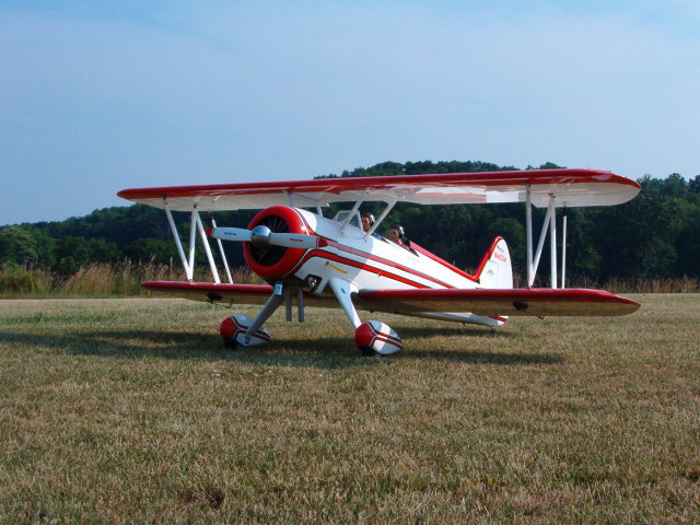

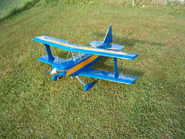

And just to rub it in, here's a pic of it and my G26 powered Stearman and my old and no longer owned CG Ultimate that had a TS110 in it and now soon to be completed GP Ulitmate 160 size (no pic yet)

Oh man, now there is 2 of you I have to deal with
I guess I won't tell you both that I'm considering the Military version Great Planes has out of the Stearman next and that's while I'm building a SIG Pig this winter.
Beleive it or not the Stearman only has about 20 or so flights on it. It's one of those ones I only take out on a very nice day and I'm doing an airshow. The smoke system really sets it off and the G26 from RCIgnitions is a perfect match. The prop on it really sslows it down but boy does it set it off
Hey Ken, WH has the Ultimate on sale for about 70 bucks off then what they normally sell them for.
Maybe Santa will send you one. All you need to tell him which color, the purple trimmed one or the tan trimmed one

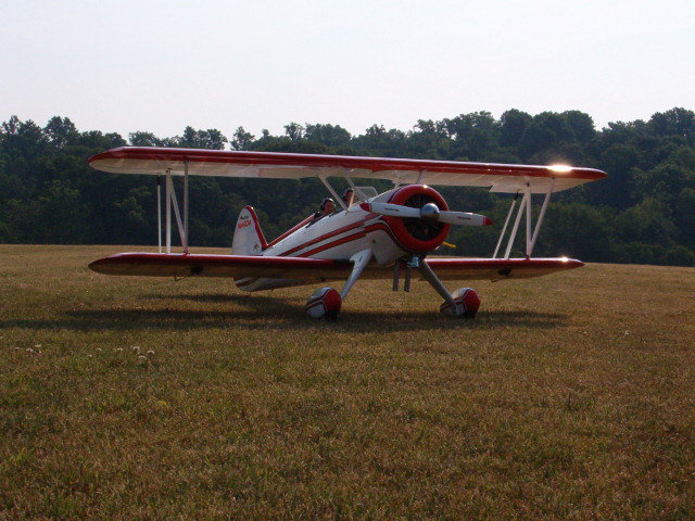

Here's a better pic of the Stearman Tiger is gonna get jealous and don't worry about us Hydro, this is an ongoing thing between Ken and I. He's a big bipe lover also
