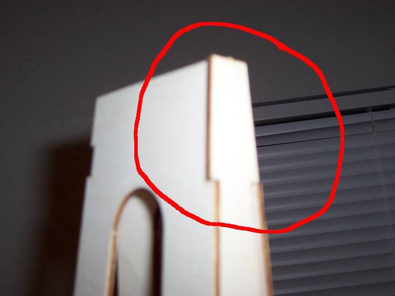

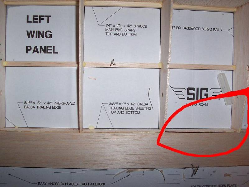

ok heres the first pics(just got to start on it a little bit ago)
the two circled areas are booboo's i made while building....someone want to comment on them, and how bad they may be

ORIGINAL: txaggie08
On the trailing edge--just sand it untill it's smooth. On the rib--where there is a gap--fill it with baking soda and put a couple drop of thin CA on it. Makes a nice fillet for filling in the gap. It's hard to sand though--so don't glob a bunch on there and build it up too much.
Lookin' good.

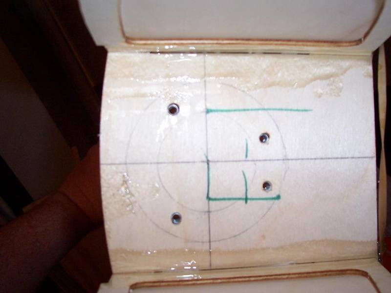

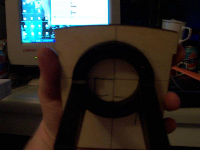

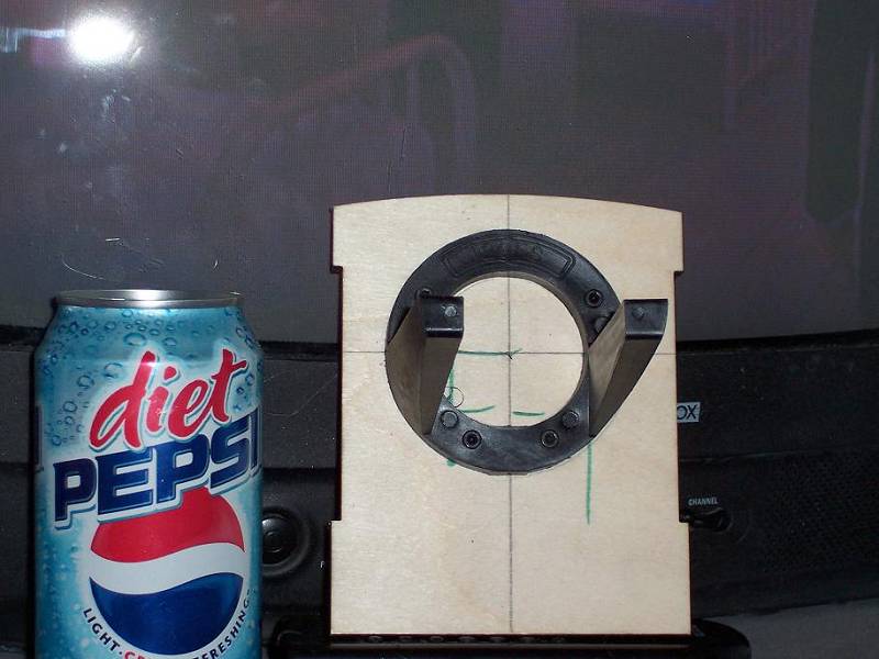

motor mounts on. Fixing to drill the hole in the f-2 fomer and get started assembling the res tof the fuse.

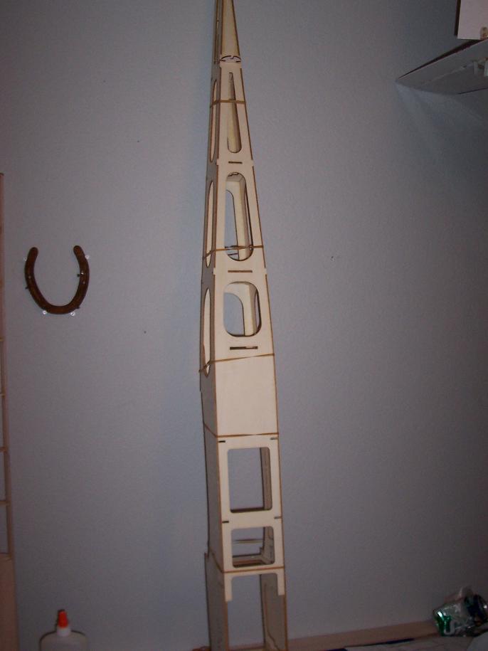

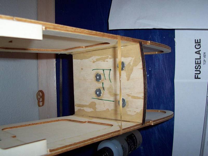

these will be ti for pics for tonight at least

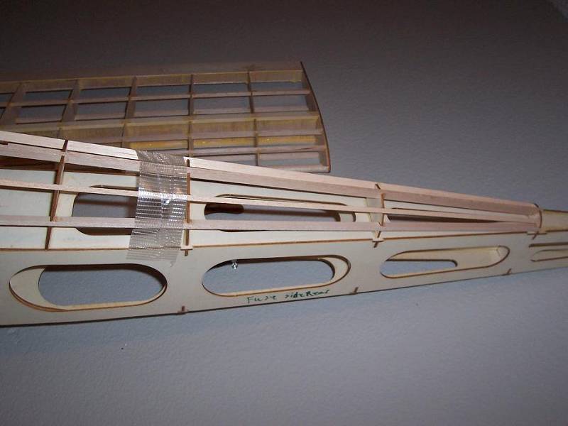

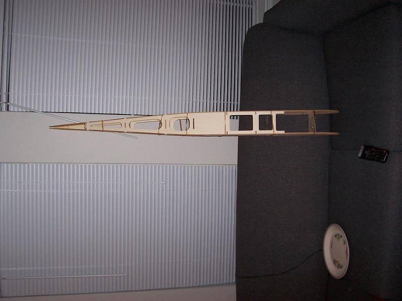

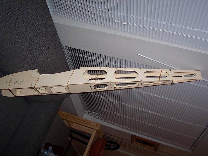

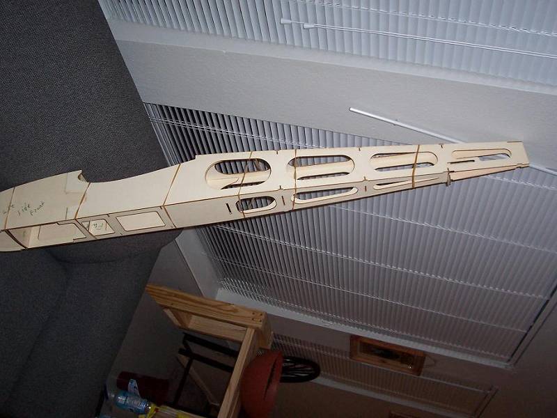

a question on the last one, should the bottom of the fuse be instaled that way with the tail wheel mounting block addition on the inside or the outside? i think thats done right but they dont show in the plans or directions
The fuse is not glued, just locked together with rubberbands.

Default RE: Four-Star 120 build getting started.
On my 4*60 the tail wheel mount went on the inside. I think that would be best.
Patrick

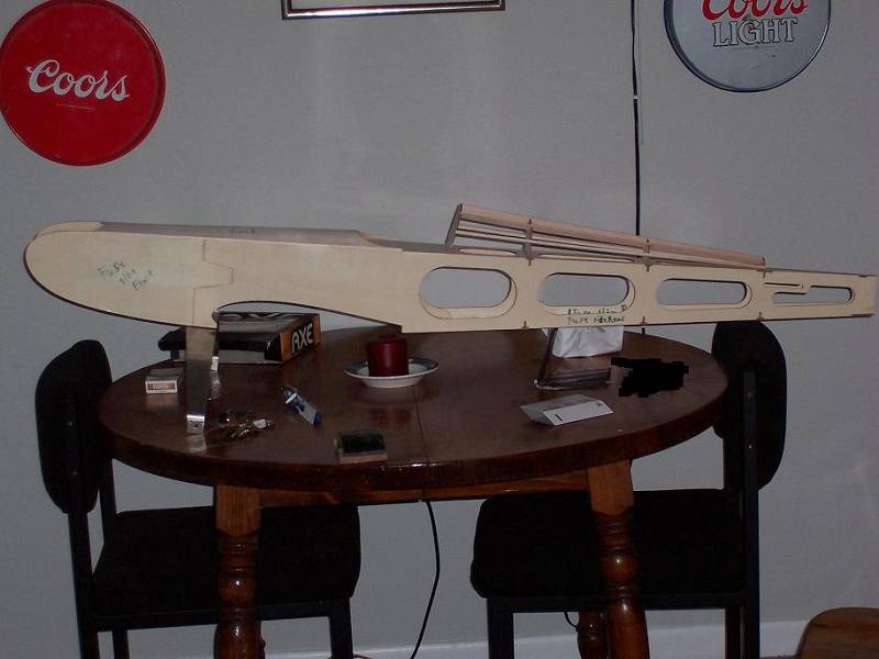

Ok folks big milestone.
Thsi is the first picture of the fuselage entirely assembled. Ill start filling gaps and sanding this evening i think.
