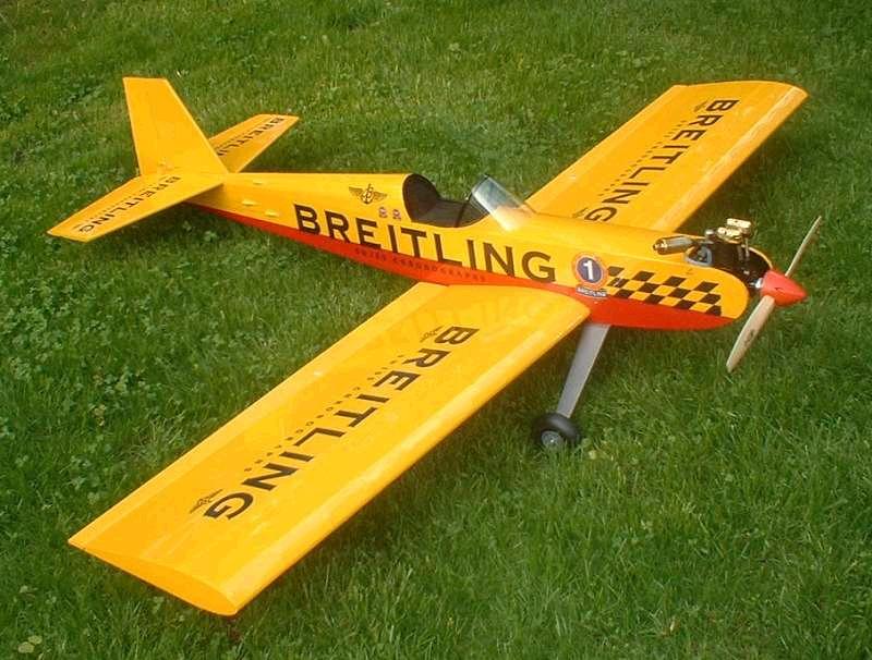

Here is some inspiration for you. The open cockpit is an easy mod.

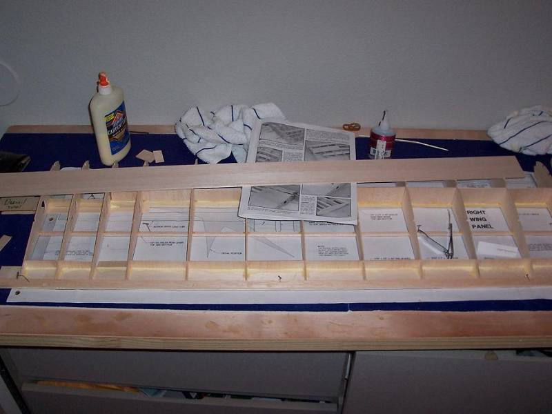

From: College Station, TX
Default RE: Four-Star 120 build getting started.

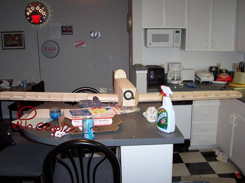

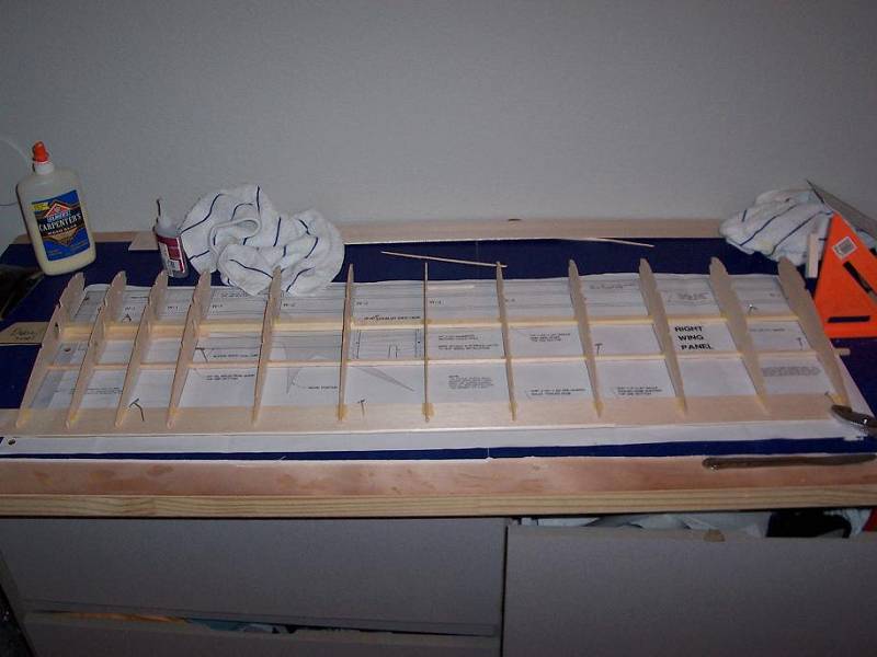

Heres a pic of the right wing going together. I have to write an essay for american history(post 1877), then ill get back to it..

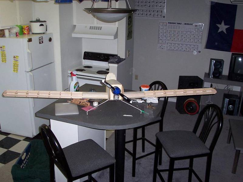

Old 11-16-2005 | 12:35 AM
  #29
txaggie08's Avatar

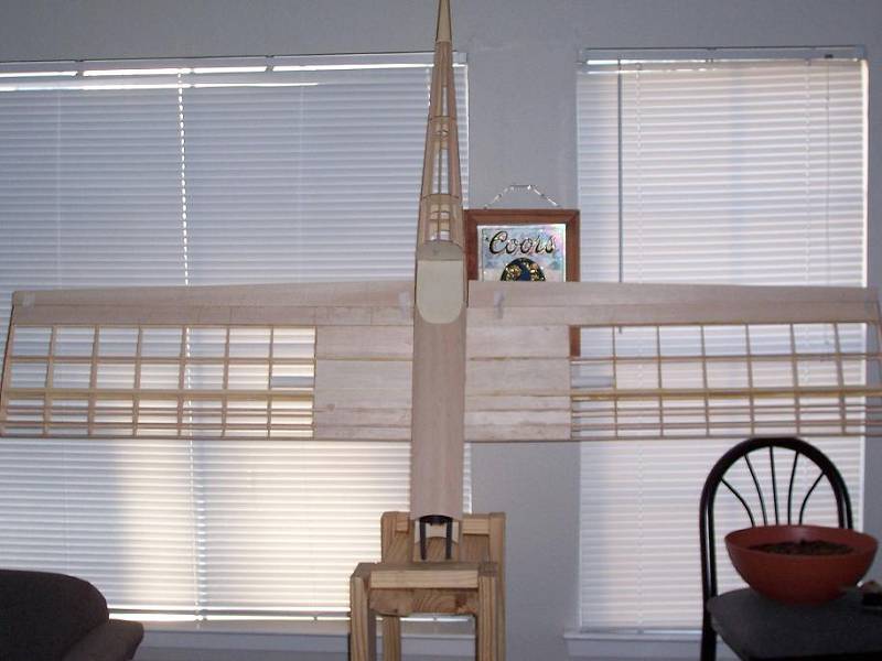

a little sheer webbing

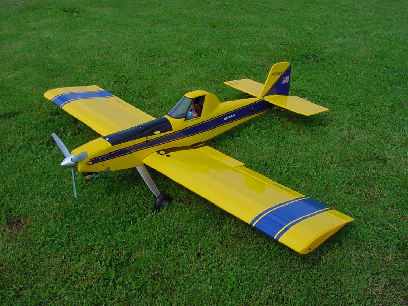

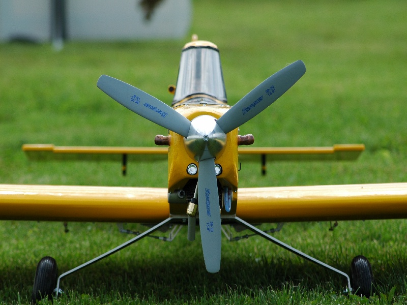

TxAggie - Your doing great, will be a great flyer Don't be afraid of a few mods either, just plan for them before hand.
Here are a few mods I made to my 4*120, it was lot's of fun and flys great Has a Saito 150 inverted in it with a 3 blade Graupner on it.
If your at all interested, I have a bunch of build pictures on my website, [link=http://groups.msn.com/PuttsRCHomePage/sigfourstar120build.msnw]Putt's RC Home Page[/link] .
Enjoy your build

Ever have on of those moents were the sheer scale of something sets in...........
This is a little scary just how large it is.....i mena on an intelectual level i realised but god in heaven..............

ORIGINAL: txaggie08
It seems huge when it's indoors. It will seem a little more reasonable when it's outside. When it's in the air it won't seem so huge any more.
The only problem I have with mine is that it's too light (about 11 pounds). With the Saito 150 at idle the thing keeps taking off again every time I try to land. I have to kill the engine to land it! Im going to mount a camera on it somewhere just to add some weight.

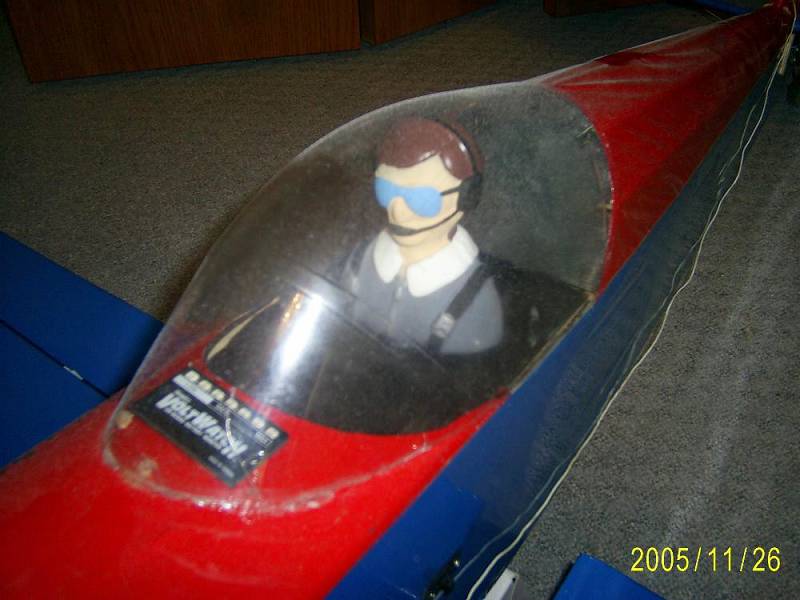

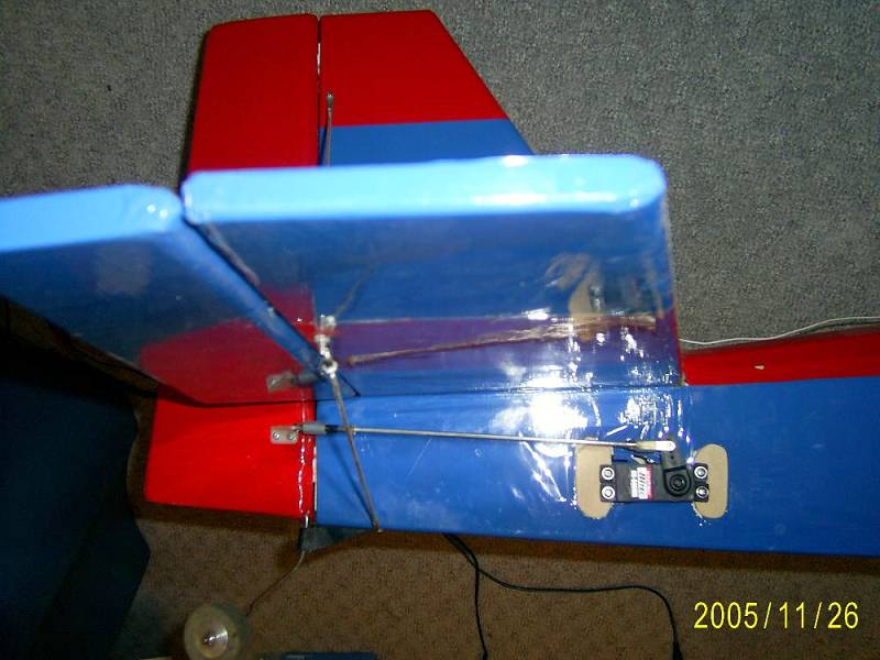

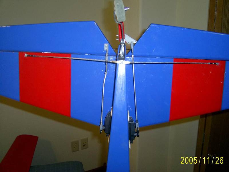

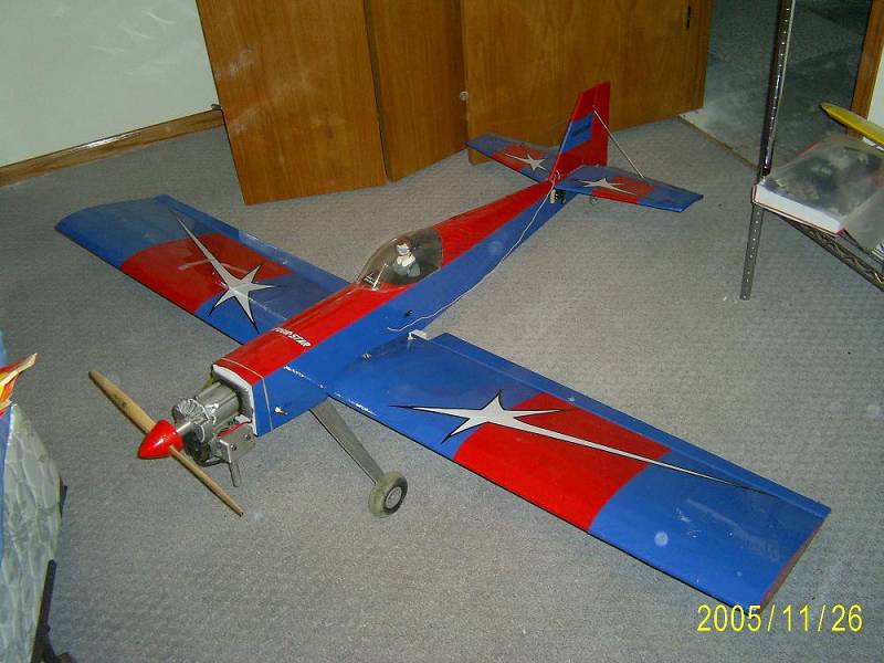

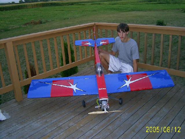

Hey,here are some pics of my Four Star 120 that i finished up a few months ago...engine is a 25cc homelite weedwacker conversion i did my self with parts from wackerengines.com...over all it was an awesome plae to build and it flies like a dream!i mounted serovs in the tail to counter-balance the engine weight,beefed up the firewall,and adjusted the cockpit a little to make it flow better with the turtle deck.kinda like a cap or edge...havent gotten the final weight but im guessing around 15 lbs...the engine is about 4 lbs but the plane handles it fine and dead sticks are gentle...good luck to everyone building..the only hard part about it to me was sanding such a huge model..i used a power sander for the thick fuse sides and did the rest by hand...covering is a little hard too..anyways,keep it up...Dustin
