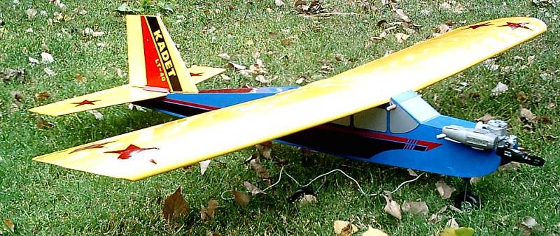

Fine lookin lil' bird there Septic.[sm=thumbup.gif][sm=thumbup.gif] I would have to agree that checking out your local club first is a very good idea. You're gonna need to do that as well as getting your AMA membership anyway to have a place to fly. So why not go & visit the club first, meet the Instructors, see what they are willing to train you on. Some people are very set in their ways, & may or may not want to train on the new P-51 PTS. You never know, but it would surely be a shame to go out & spend all that money only to find out no-one close to you wants to try teaching you on the thing. Go check it out first, see what they say, they might love the thing, like I say you just never know, till you go & ask. Good luck, & Merry Christmas to all.
Mark

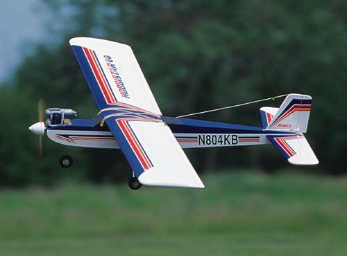

I am suggesting you to buy a Hobbico Avistar 40 or Hobbistar 60 trainer.
If you have low badget go with the Avistar and buy a cheap but dependable OS 46 LA.
Or if you want something more stable go with the Hobbistar 60 trainer and install an OS 65LA in it.
Also if you want more power and " speed " which is not advised to a newcomer,you can buy the OS 61 FX engine.
Of course there are other engine manufacturers that offer there engines at extremely low prices such GMS (Chinese one),
but i haven't ( and won't plan to buy one ) saw one of them working so i cannot suggest them.
Quality between engine manufacturers is not the subject of the thread,i am just suggesting OS engines,because they have everything a newcomer wants:
1) performance
2) reliability
3) dependability
So,here is a link to above trainers!
Compare these airplanes with other suggestions of RCU members.
[link=http://www.hobbico.com/airplanes/hcaa2125.html]Ηοbbico Hobbistar 60[/link]
[link=http://www.hobbico.com/airplanes/hcaa16.html]Ηοbbico Avistar 40[/link]
[i]Also i forgot to mention the Nexstar!-->Excellent trainer too!
[link=http://www.hobbiconexstar.com/hcaa2025.html]Hobbico Nextar...[/link]

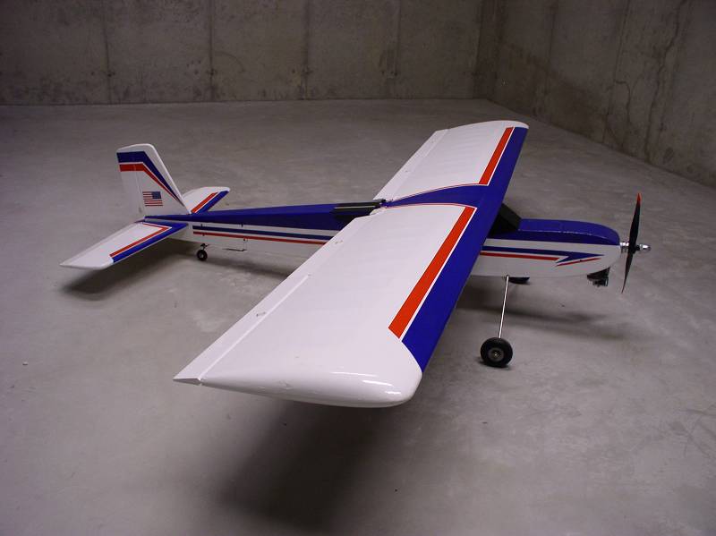

Just stumbled across this thread.
18 months ago when I got into this hobby, I looked at the choices and settled on the Hobbistar 60 with a Saito 91. This is a very good flying combination with the added power of the Saito helping you to take off "with authority" or accelerate, pull up, and go around when you botch a landing approach! It's also one of the larger trainers (71" wingspan) which helps the novice pilot make a correct assessment of the plane's orientation, especially when flying high and/or on the outer downwind loop. And the semi-symmetrical airfoil gives you the option to start basic aerobatics.
After solo'ing with the 'Star, I went on to buy, and still fly the Zaggi Tazz, the H9 UltraStick 60 (w/ Saito 100), and am currently mounting the Robart 609HD (85 degree, 3/16") retracts into my Saito 100 powered H9 P-51 60, which hasn't maiden'd yet. The Tazz has allowed me to rack up tons of valuable "stick time" in a field across from where I live instead of driving 20 minutes to the local RC airfield.

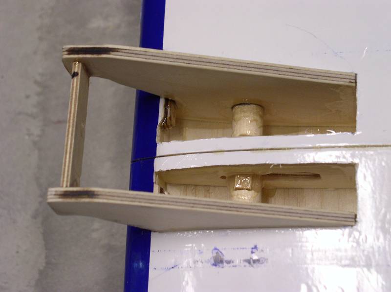

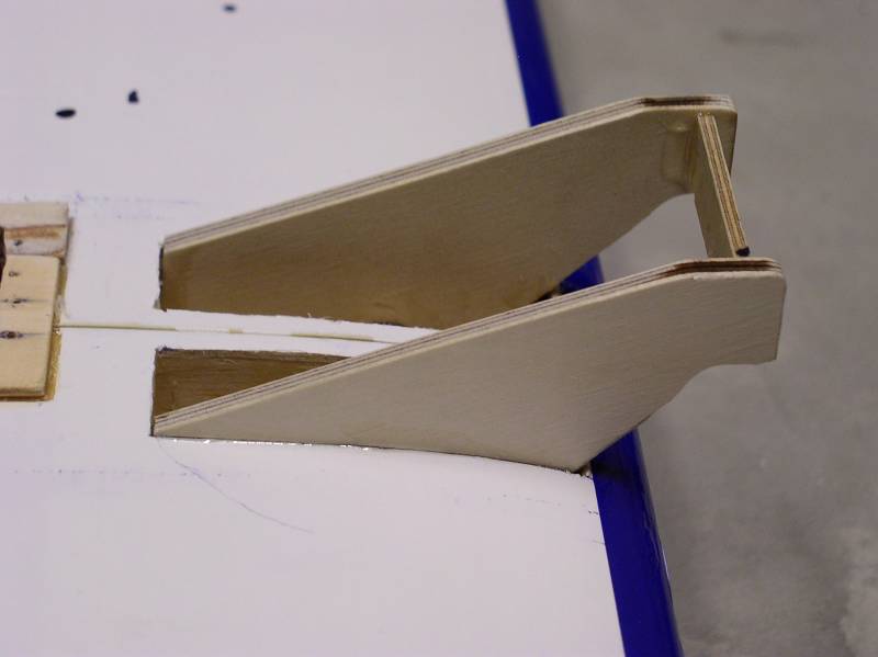

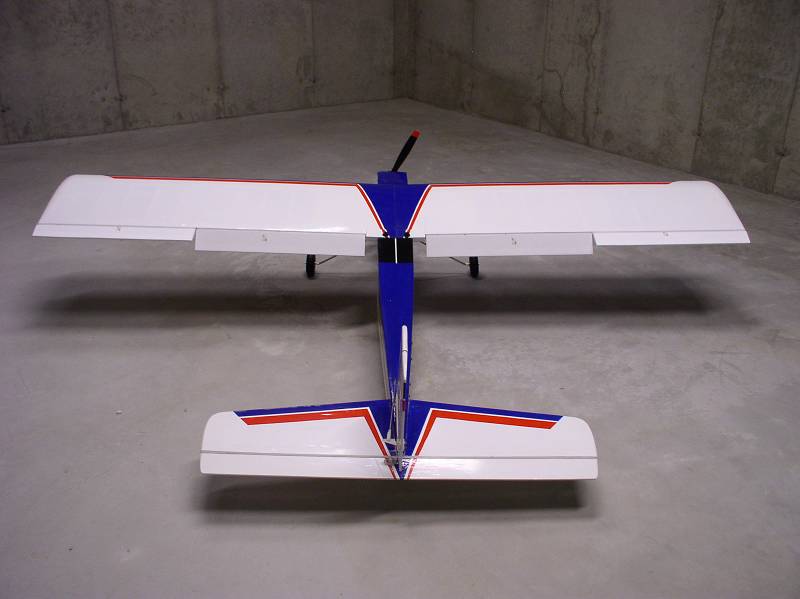

My winter side project (since I am still working on the 'Stang) was inspired by the recent articles in the AMA magazine about upgrading the Hobbistar. With about 12 hours of work, I was able to take what was basically a "retired" high-wing trainer and make it into a more interesting, and versatile sport flyer. Ditched the rubber bands and converted to a bolt-on wing (unique front attachment bracket that slides under the existing dowel), converted from tricycle to steerable tail-wheel, inverted the Saito 91 and added a top cowl, and replaced the full-length 1.25" chord ailerons with 2" split ailerons and flaps actuated by in-wing servos.
Total cost was ~$50, most of that in the 3 extra servos added to the wing. With the weight of the tail-wheel, its internal anchor bracket and my internal/external custom steering rig (rudder servo, pushrod activated, pull-pull tailwheel steering), I had to move the on-board 1650 mAh receiver battery forward under a hatch and on top of the fuel tank to get it to balance properly (with no added dead weight, though it jumped in total from 7.5 lbs to just over 8lb; nothing the Saito and the flaps can't handle!).
Taxi's and flys excellently with these mods, and the landings with full 45 degree inboard flaps is much slower than the stock Hobbistar, which (my only complaint) in stock form still has higher wing loading than something like the Cadet. Pics of the mods below.
Bo
