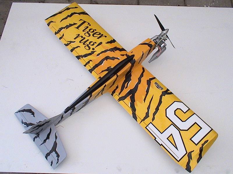

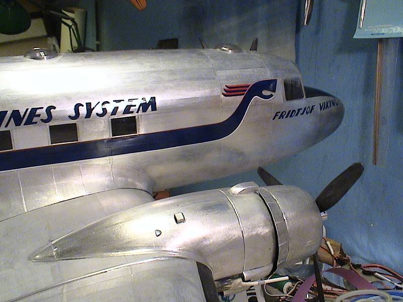

Default RE: ultracote problems
Hi!
Sounds strange!
Oracover (Ultacote in the US) has never failed me.
Did you really heat it enough!
On the covering iron I use I have it adjusted to max heat when using both Oracover and Monokote. Only occasionally do I change to a lower temp.
Regards!
