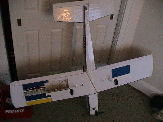

If you've got am extra channel, a real easy thing to rig up is a couple of large flaps on the bottem of your wing. You don't need to mess with your ailerons, and it only takes a couple of nights to add. Take a look.

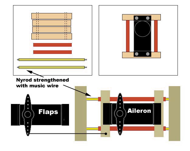

Here's another easy way to incorporate flapperons without a computer TX...

MikeB,
Crafty!
