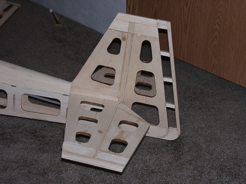

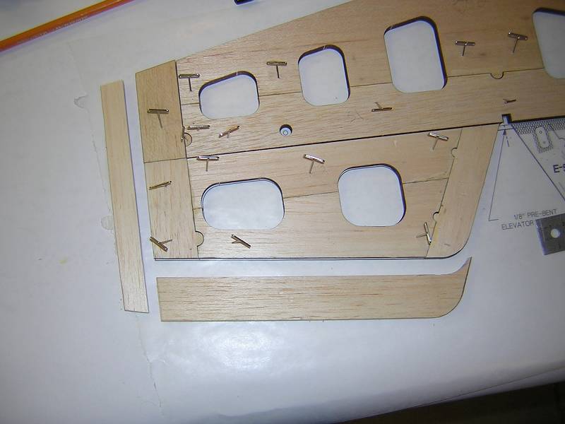

Hi. I just got started on this kit today. I have the right wing nearly built (no sheeting yet). And have modifed the elevator / hor stab as can be seen in the following pictures. Everything locks into place pretty tightly, and my added width on elevator is not on existing seams. I plan on rounding it more on the ends to make it sleeker.

If you are going that much in oversizing the elevator, then I can probably assume tht you are looking for extreme control throws as well. If that is the case, then you will most definitely need to open up the inner elevator to allow for greater rudder deflection.

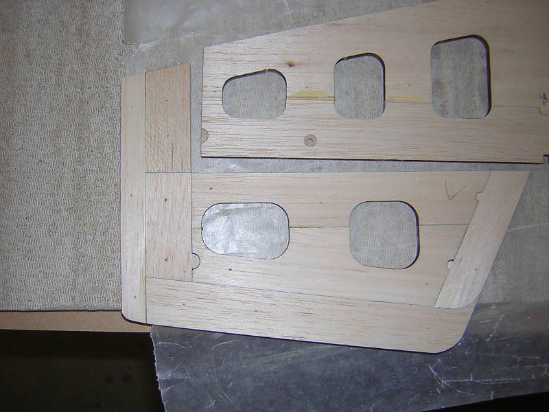

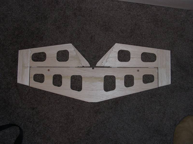

You might drill some holes to lighten up the tail a little. I added some to the rudder and widened the v in the elevator for clearance also added counter balances and the plane came out tail heavy. Battery located under the tank and a little weight on the nose with a balsa cowl added.

Excellent points, guys. I shall get busy with the dremel and lighten things up a bit. I didn't think about the rudder clearance either. Thanks.

Thanks for posting those pictures of the extended rudders and elevators. I've got one of these planes on my building board right now. I just covered the wings and I plan on extending and covering the tail section this weekend. I don't want to add too much weight (I'm going electric with an AXI 4120) and wonder how much is extension is enough for good 3d flight. Until I saw these pictures, I was going to simply CA on a solid 1" strip to the rudder.
h@h - your rudder extension looks kind of weak (no insult intended)... Has it seen airtime yet? Does that extension hold up to the pressure of tight turns or does it flex? I'm asking because I would love to simply stick up an extension like you did, but I worry that it might snap off. If it has seen airtime, is the extension so extreme that you only use a small degree of rudder travel? Would you have done it shorter, longer or the same length if you could do it again?

Working on the second gallon of fuel and still in one piece. I have seen a picture of a modified rudder that they added to the middle at the seam. Its only about 1 inch longer. Rudder is set so it misses the elevator by about 3/8 of an inch and it has been used.

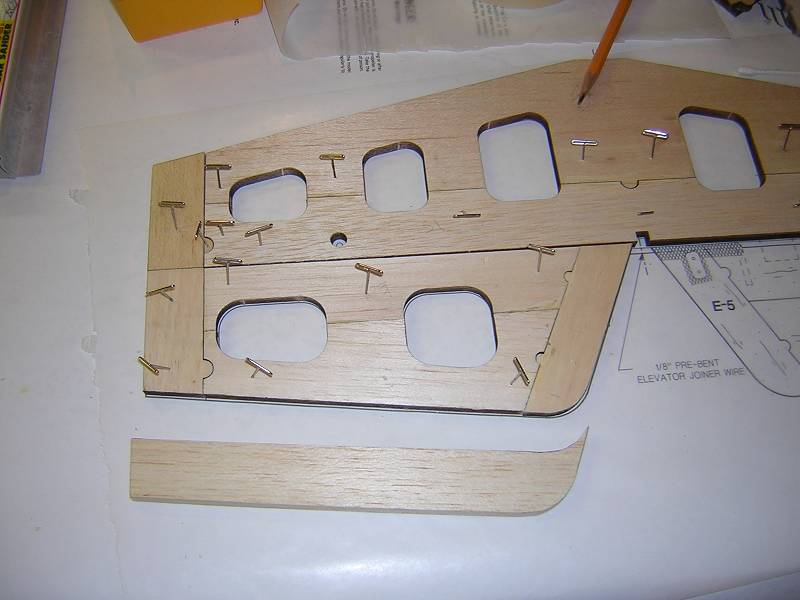

Assembled some of the tail and control surfaces tonight.
Added 1" to the rudder.
A couple of the pieces were cracked outta the box and needed to be CA'd. Will glue those up tomorrow.
