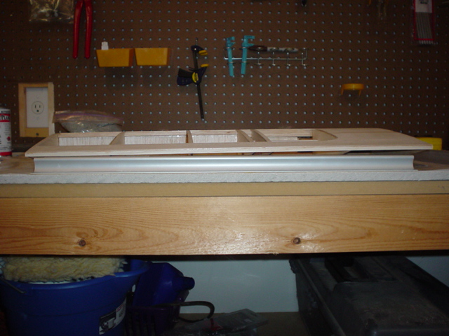

I have the top of the wing sheeted, tubes in and secure. I've lifted the wing off the building board and I'm ready to sheet the bottom of the wing. The manual calls for a straight 1" board a little longer than the wing to set the trailing edge on. Both the spar on the bottom and the trailing edge need to be secured flat against the building surface. This wing is still a little flexible so I take it the mounting of the bottom sheeting along with the lower spar and trailing edges being parallel with the building surface will tie it all together and I wanna make sure I get this right. The wing is tapered so once pinned down this side will be flat while the other orientation will have the trailing edge a bit higher on one end than the other.
Am I thinking of this right?
Appreciate any input!

Yes, the sheeting of the bottom will create the "D" that gives the wing it's structural integrity. If you don't use the 1" piece to support the trailing edge you could build a twist into the wing that will be permently locked in. Some plans call for washout (not the SE) where you raise the outer trailing edge and then lock it in when sheeting. If you have a table saw you can cut out the 1" from scrap 2x4.

you are correct, here's a picture of mine when I finished sheeting it. I was worried I screwed something up, but it's exactly right & both sides were identical.
When I finished sheeting the top of my first wing & flipped it over on the straight edge it had a slight twist & didn't lay perfect. I just put some weights on it while I sheeted the bottom & it firmed right up & stayed straight. I recall the manual stating that when you finish this step it will lock the wing into shape.
If you dig through some of the old build threads there are some who see this as a flaw in the kit because a symetrical wing should be perfectly symetrical, but I think the odds of you or I trying to modify the wing to make it perfectly symetrical are probably not too good.
btw, your wing is looking good!

Great - thanks for the sanity check, tuwood!

Got the wing secured on a 1" block and the building surface. Mounted the front edge of the front sheeting and the rear piece of sheeting.
The wing had a little twist in it before I got it secured. Used several pins to get it secured flat.
I only had a 3/4" board so I glued on two layers of scrap balsa to make it 1" thick.
