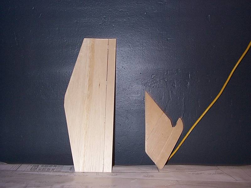

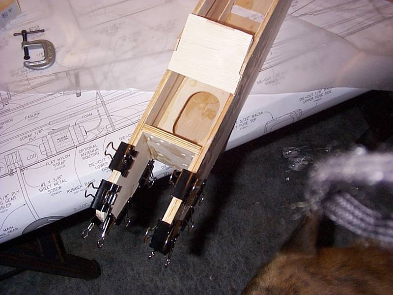

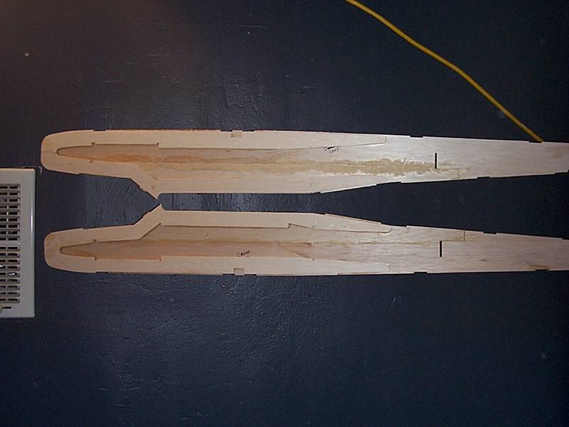

well the first night was pretty good,i sorted all the parts and labled everything,i think i only used my knife twice to remove the die cut parts so my hats off to great planes for that.got the stabilizer,the fin and some of the fuselage done,also the engine bulk head and the wing bolt plates.i do recomend the hing marking tool and the power slot hinge tool,wow it made this task easy and very accurate. the fusealge went together great with little sanding to fit all pieces. the one problem i had was using ca medium to glue in the fuselage doublers,instructions call for ca medium and these parts are so long and the instructions says very impotant to be accurate,i think maybe 6 minute epoxy should be used here as you have hardly any working time to move them around. i had a hard time getting away from the table and get to bed for work. im sure ill run into problems at some point but having the manual for 2 weeks before my kit got here i read and reread it and took notes and have prepared for alot that really has helped,here are some pictures so far my first time posting pics so see how it goes,thanks steve,,,ohh sorry about the caps in first post guess i was excited[img][/img]
ID:	390041   Click image for larger version

I use 30 min epoxy for laminating the parts. 5 min epoxy is brittle and not as fuel proof as 30 min epoxy.
The PT40 can be an excellent flying plane. You will most likely want to use the lessor dihedral amount? Seems like few people use the full dihedral.
Enjoy,
Jim

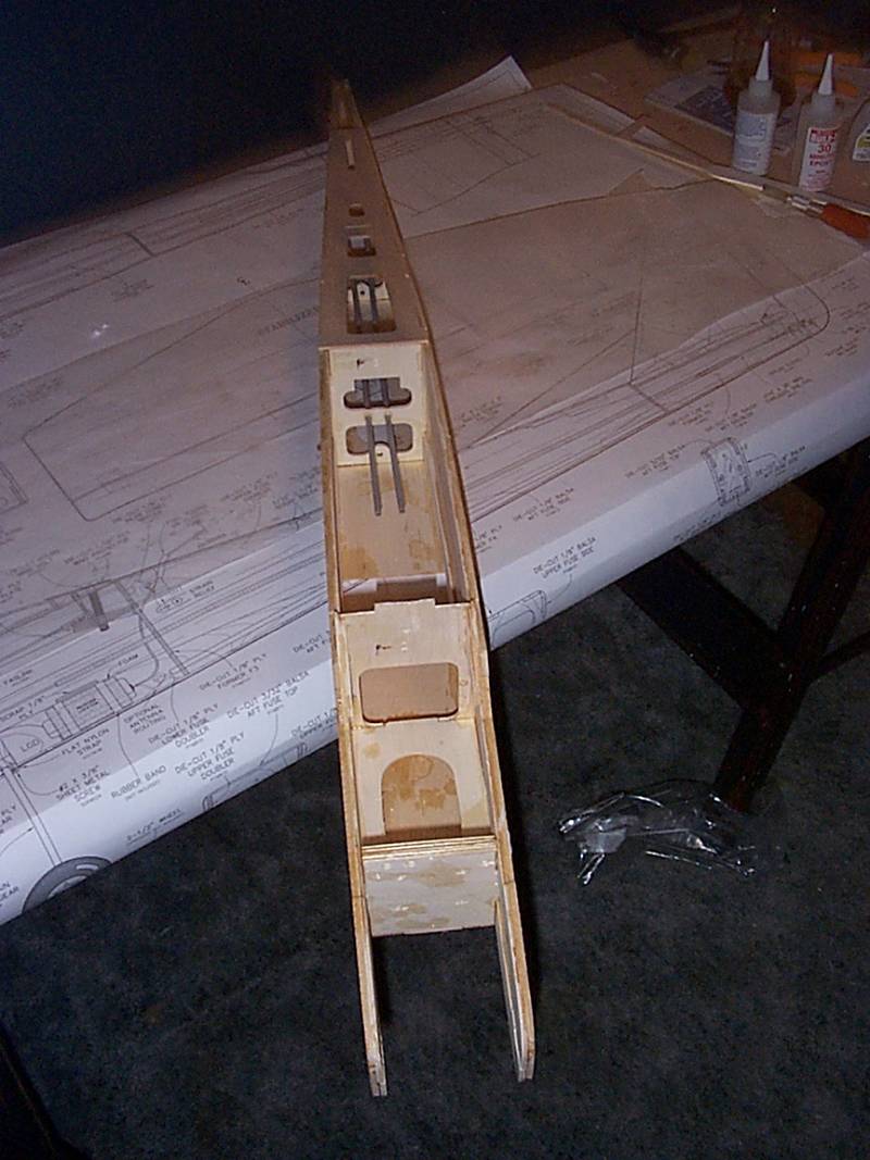

okay the B wing with ailerons it it thanks,its starting to look like a plane now,got the firewall in and the bottom of the fuselage done and all the formers in as well,pushrods in for the elevator and rudder is done as well.looks like it came out pretty sqaure. not too many problems as yet except i have 2 big of fingers when i got back to f-5 the small former at the back,i need some ca extensions for the glue bottles,i plugged up the 2 pushrod holes with glue and had a heck of a time reaching in with a drill bit and twisting it by hand,learned a lesson there,here is a couple of pics to show where im at,thanks

Hey it came it yesterday and i was able to get started on it. finished the stab and rudder then got going on the FUSE.
How did the nose of the upper and the lower match up? mine had a slight gap. required some sanding
and how about the knotches on the bottom of the FUSE side(only one)? mine did not line up exactly the way the plans showed it so i cut a little away to make it fit the plans better.
And I see what you mean by using a 6min for glueing the doubler. the CA just doesn't give enough time. And my top and bottom doubler didn't fit together as nicely as I would hope.

avgwhtboy,my upper and lower matched up well,i wish i would of used the 30 minute epoxy here to allow for more alignment time,ill do it next build for sure just the learning process,i didnt have to cut my slot any on the bottom,thats for one of the formers that goes in there and made was just fine,just watch out when u glue in f5 that you dont get glue in the holes like i did,not fun,so good luck this ought be fun we are close on the same plane

I had a small gap(paper thin) between the upper and lower FUSE, but when i did some sanding I just pushed it in there and wicked some ca+ in there. filled it right up.
theo I used epoxy for the doublers and the firewall, Definatly made it very solid but took much longer. I couldn't find my drill bits so i had to bring the firewall and the f2-f5 pieces to work to get it done.

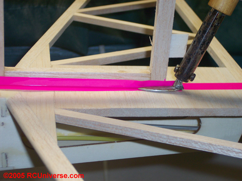

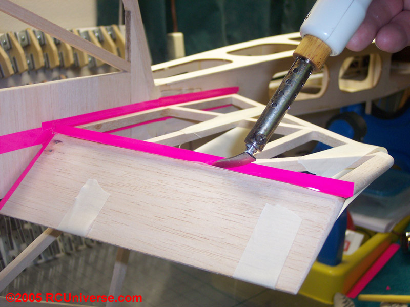

I covered mine before installation. When RCKen gets to the covering portion of his LT-40 build he is going to show his method for covering them after installation. It appears that either way is fine but I thought doing it before mounting looked easier.
Old 01-20-2006 | 03:35 PM
w8ye's Avatar
My Feedback: (16)
Posts: 37,576
Received 11 Likes on 10 Posts
From: Shelby, OH
Default RE: G.P. PT 40 MK 2 TRAINER BUILD
The difference is that with the fin and stabilizer already installed, you put small strips of covering at the intersections. Then you cover the large portions
But either way, you should cover before installing hinges even though they can be covered afterwords, its not as easy.

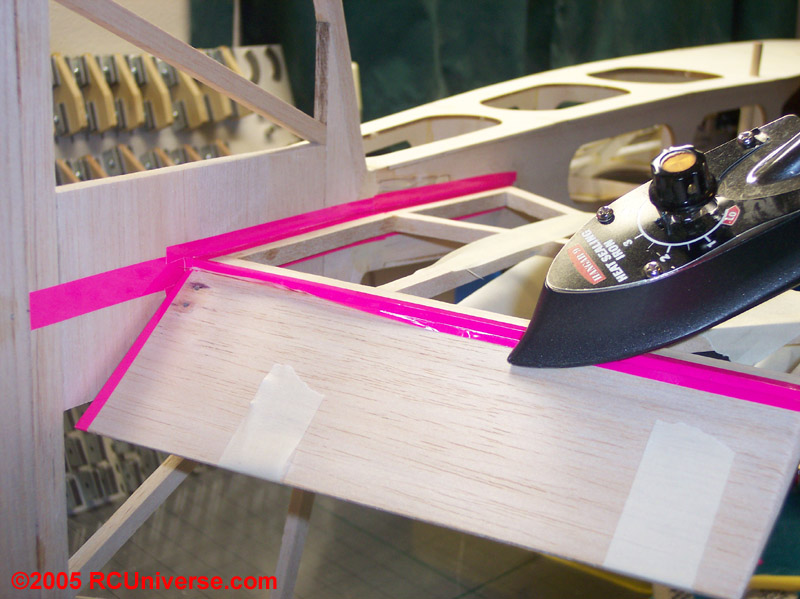

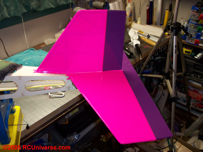

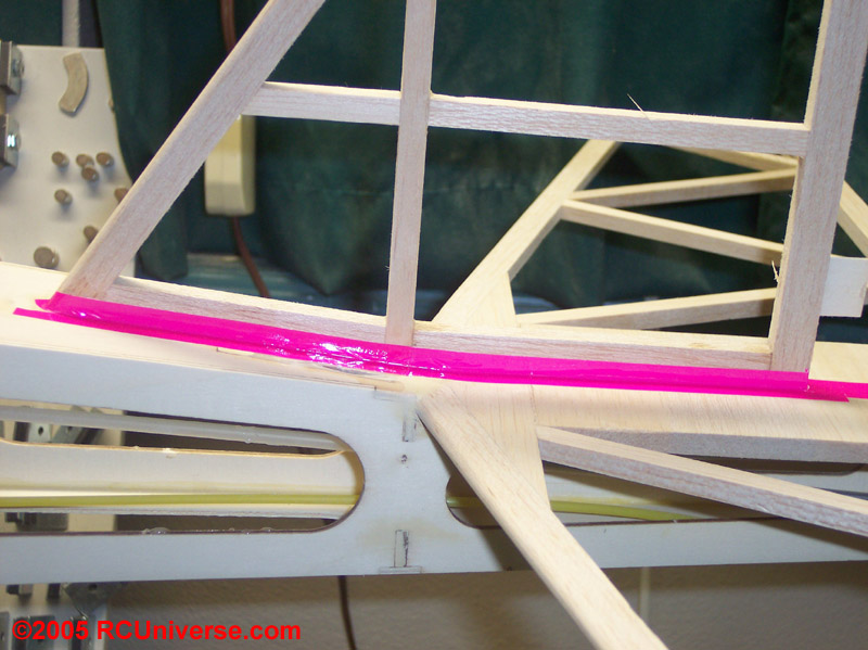

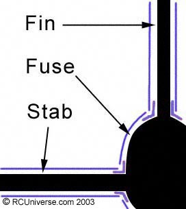

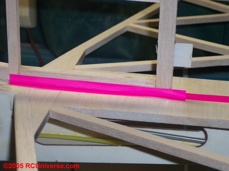

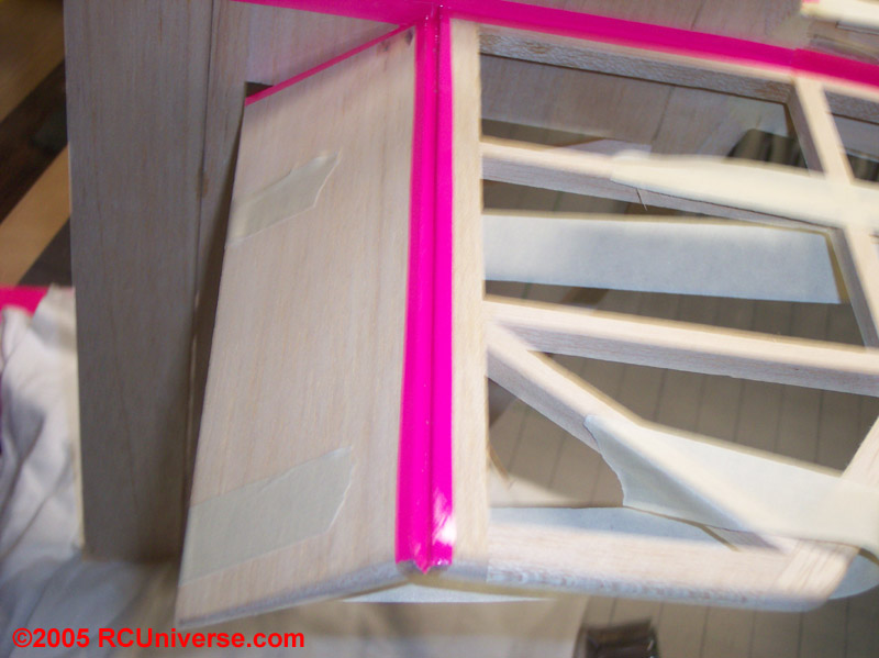

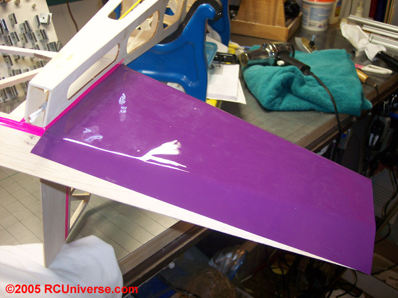

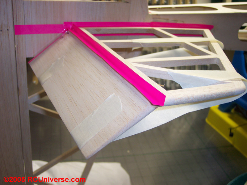

I build a little differently than most people do. When I build I like to completely build the plane before I cover it, and that included gluing the horizontal and vertical stabilizer. I will also glue the control surfaces on before I cover too. But before I glue the control surfaces in place I will cover the ends of the control surfaces. The reason I like to assemble first is that I absolutely hate cutting into a covering job to add weight to balance the plane. So I will completely assemble the plane (with the exception of the covering of course) and then balance the plane, then cover the plane, and recheck the balance after the plane is assembled again. Sometimes the plane needs a little bit of adjustment in the balance after being assembled but that can usually be accomplished by moving the receiver and battery location. When it comes to covering I do put a small strip of the covering where the surfaces meet and the cover over that, see the included pictures to get an idea of what I'm talking about.
As I said above I also glue the control surfaces before I cover, and then I will actually cover and seal the gap. I do this for two reasons. One is that the covering seals the gap which improves the performance of the plane. Second, sealing the gap (especially when using CA hinges) will help prevent failure of the hinges. In essence when the gap is sealed with covering you now have two types of hinges, CA and covering hinges, which makes for a more reliable plane. When sealing the gap I will use a strip of covering folded in half and placed in the gap between the control surface and the trailing edge that it's attached to, then heat the covering to seal it in the gap, and finally sealing the edges of the covering to the control surface and the opposite trailing edge. Then when covering those surfaces cover right up to the gap.
Hopefully these pictures will help explain a little bit better.
Ken

Ken,
Excellent demo. You do good work.
Jim
