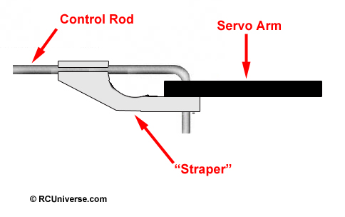

Actually, maybe there is...you have any good pages about installing control arms and zbends and such...seems so easy, then i went to do it and got dumb all of the sudden...and whats the best hardware for it? Need it for the dual ailerons...

Here is my list in order of what I prefer for connecting pushrods to servos.
1. Ball links [link=http://www2.towerhobbies.com/cgi-bin/wti0001p?&I=LXD897&P=0]Dubro Ball link, threaded[/link]
2. Solder Clevis [link=http://www2.towerhobbies.com/cgi-bin/wti0001p?&I=LXD895&P=0]Dubro Solder clevis, 4-40[/link]
3. Z-bend [link=http://www2.towerhobbies.com/cgi-bin/wti0001p?&I=LXXC81&P=ML]Great Planes z-bend pliers[/link]4. L-bend [link=http://www2.towerhobbies.com/cgi-bin/wti0001p?&I=LXAZC3&P=0]Dubro E/Z Links[/link]
5. EZ connectors [link=http://www2.towerhobbies.com/cgi-bin/wti0001p?&I=LXD925&P=0]Dubro EZ connectors[/link]
The first diagram is a how to for making Z-bends. The second diagram shows what L-bends look like.
I know that there are those that disagree with me, but I don't like using EZ connectors on critical flight surfaces like the aileron and elevator because I have seen them come loose in flight and if that happens you will loose the plane. I use them on non-critical applications like the throttle and nose gear steering.
Hope this helps
Ken

Thanks for the info ken, on the control selections, im liking the idea of the ball link....i trust it more now that ive flown helies...
