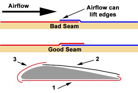

Default Covering Help!
And always start at the back and work toward the front. That way the airflow won't lift your seams.

Old 11-28-2002 | 05:00 AM
Posts: 1,405
From: Salmon ArmBritish Columbia, CANADA
MinnFlyer:
You have a handy dandy, oh so explanitory illustration for just about every newbie question!
When is the book coming out!
Seriously, as a newbie, these are more enlightening than sone of the 500 word novellas that others have written. I hereby offer to host a web-site full of your pictures!
