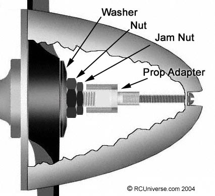

Hi, I am new to RC airplanes and am almost done with my first airplanes except i have a couple of questions.
1) Do i drill holes in the engine mount so that i can put bolts through the holes on the side of the engine and through the engine mount???
2) Does anyone here have a step by step description of pictures of installing a spinner / cone on an engine???

As for mounting the engine, I prefer to drill and tap my holes either 4/40 or 6/32 depending on the size of the engine. As for spinners, all of them come with mounting instruction's. Most of them have bushings that need to be installed, according to your shaft size. The spinner back plate goes up against the thrust plate on the engine followed by the prop, followed by the prop washer, follwed by the prop nut. Then the spinner is installed and all the screws or bolts are then tightned to hold the spinner on the back plate. Good Luck, Dave

As for the spinner, take a look at the attached diagram. It should give you a pretty good idea of how to assemble and mount the spinner. While it's not for an exact make of spinner, they are all pretty much similar so you should be able to figure out what you need. If you still have any specific questions about this please feel free to ask and we'll do what we can to get you squared away.
