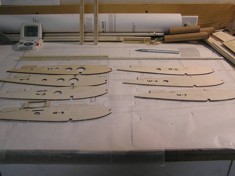

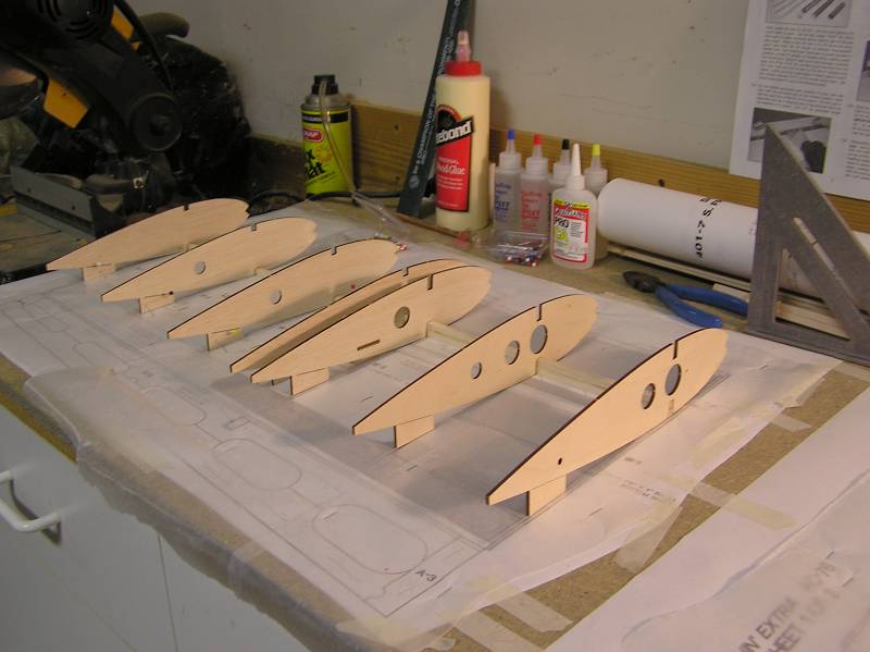

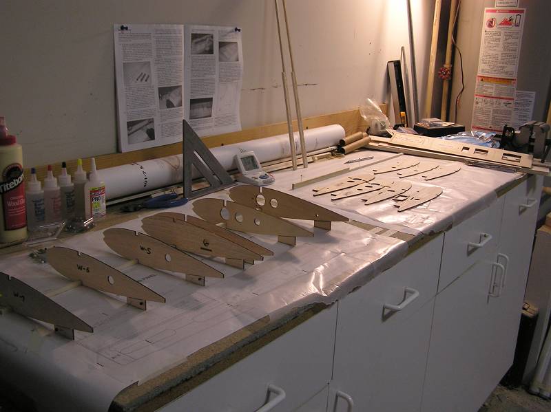

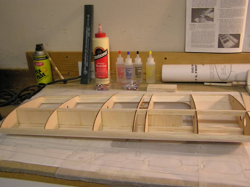

Hey every one I started building today!! The first pic is the left wing after about an hour. The second pic is my workstation. The third pic is the right wing after maybe a minute. Will post more pics after getting more work done on wings. You can see wood glue in the first pic but Im using CA, on the wings at least.
Karter

Looks like you cut up your plans. It's better to get it copied at Kinkos or similar (make sure they don't distort the copy). That way you preserve the plans for later uses such as repair/replacement parts. Secondly, as a decrepit old man, I prefer a work bench I can sit at and work for extended times. Being young, you won't need that as much. Looks like you have a good work surface and are making good progress. Suggestion-a small fan to blow CA fumes away from your face so they won't irritate nose, eyes and lungs. You may not feel the effects now but may in the future

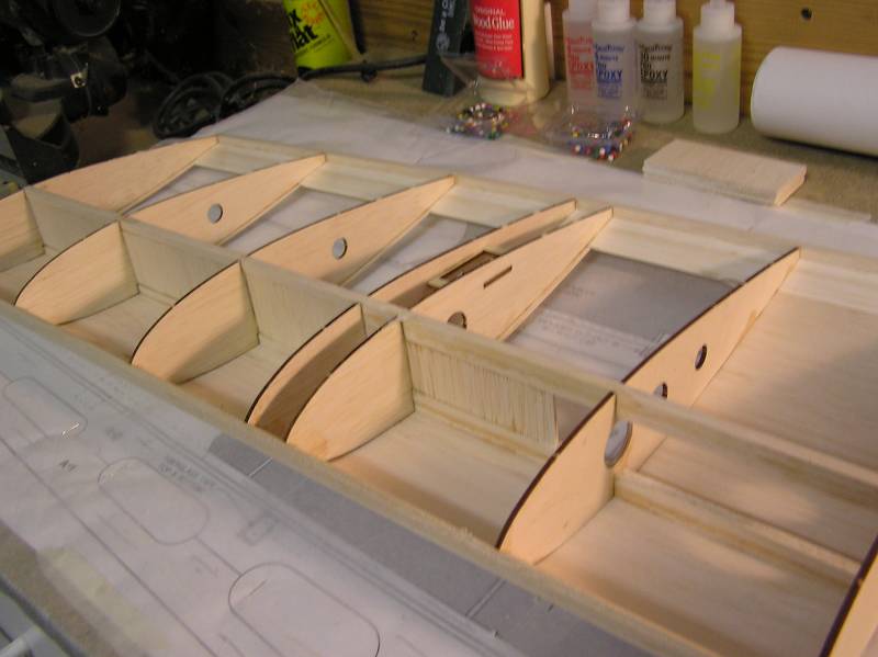

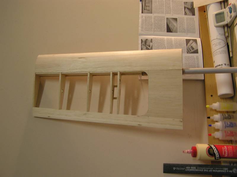

I spent about an hour and a half putting on the trailing edge, leading edge, vertical web shearing, and top spar. I see what you mean bruce with the CA, I was glueing the top spar in and the my eyes started to sting from all the CA. I will be sure to get a fan tomorrow.
Karter

Can't be 100% from just the pictures but you appear to be doing very well on the build. Remember to take it easy and think through every step carefully. Faster to take your time than to need to go back and undo a mistake, usually cheaper too.
BTW fan doesn't need to create a hurricane either, just a gentile breeze. If too strong at lowest setting, move it further away or find a way for it to draw/suck air away instead of blowing it.

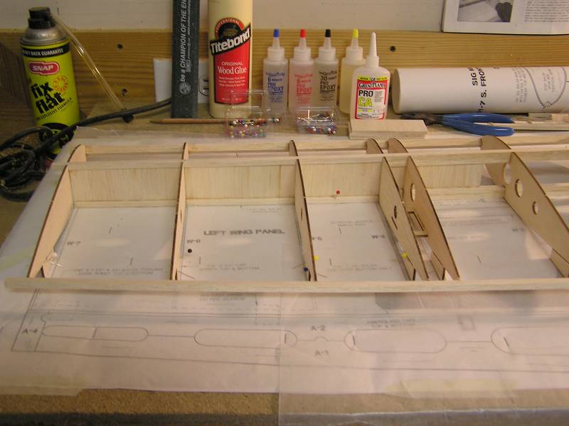

Hey everyone I sheeted the top center LE and TE and still need to sheet the whole bottom. My finish deadline for the airframe (just wooden part not covered, engine, paint, servo's) is April 6th. So I think I can be done by then.
Karter
