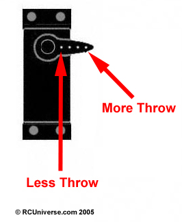

Instead of guessing and playing around with this and that you need to take a logical approach to find the problem. First of all disconnect the pushrods from the servo and see if it still buzzes. If not then the problem is in your linkage or the control surface. If it does still buzz that you have a servo going bad (if this is a non-digital servo it shouldn't buzz at all in the neutral position). Next, reconnect the pushrod to the servo. If it buzzes while it's in the neutral position then there is something about the control surface that is pushing back against the servo, you need to troubleshoot the control surface so that it naturally sits in the center position. Move the servo from side to side. If the servo moves to the end of it's travel and then buzzes the problem is that the servo is trying to push the control surface farther than it can physically travel. You need to reduce the amount of travel that the surface can move. You can do this by adjusting the position of the control rod on either the servo arm or at the control surface. At the servo arm you can move the control rod to inside holes to get less travel, at the control surface move to the outside of the arm for less travel. Adjust the position of the control arm so that you have less throw and this should remove the buzzing when the servo is at the outside range of it's motion.

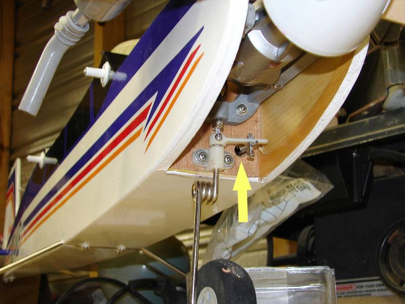

Ok, I got it fixed.
First the rudder/nose servo was in a bind because of the pushrod going to the wheel. The hole in the firewall was just big enough to slide the guide tube into. Consequently when I moved the servo back and forth the the wheel arm would swing around and make the pushrod slide against the small hole in the firewall. I just took everything apart and drilled a bigger hole. Now the pushrod has plenty of room to move. The wheel turns further than ever.

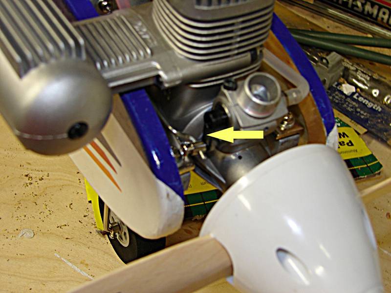

Second the throttle pushrod was basically snaked like a vine through the guide tube and came out above the engine bracket in an odd position far above the carburetor. I first cut a little notch in the frame closest to the servo to give the tube and pushrod some room. Next I put two 90 degree bends at the carburetor end of the pushrod. I got both pushrods to a point that they would slide back and forth very easy with just a push and pull of my fingers. Now they work perfectly with no buzzing at all.

I put a few pics on here to show what I did. The one with the throttle pushrod is a bit blurry but you can see the bends I put in the rod. The other just shows the hole I drilled has plenty of room for rod movement.
