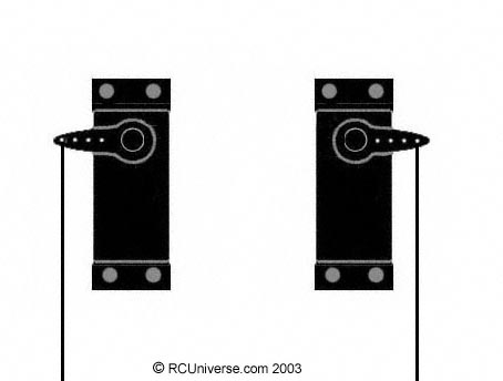

Thank you everyone for your help on the servo setup. Your all probably shaking your heads in unison at my ignorance. If I use "Y" on the ailerons, How do I set the 2 servos to move in opposite directions [one aileron up,the other down] for cordinated flight?Can I use the radio reverse servo direction for just one aileron or do I physically flip one servo over in the bay to move opposite the other? {BIG STUPID GRIN ON MY} I can see you all shaking your heads in unison again...
Danham,
the only stupid question is the one that you don't ask. So let's see if I can clear up the servo issue here. Look at the attached diagram to visualize what I'm describing. When you hook up 2 servos to a Y-harness BOTH servos move in the same direction when you move your stick. If you look at both servos sitting side by side the control arms will move the same direction. But in the configuration in the picture with the control rods on the outside of the servos, when you move the stick one side will move "up" while the other side "moves down", but in reality they are both moving the same direction (which means the control horn on both servos is moving clockwise).
So let's look at an aileron throw here. Let's say we want to do right aileron with the setup in the picture. When we move the stick right both control horns move clockwise. The right servo pushes "down" on the control rod which raises the right aileron, while the left servo pulls "up" on the control rod which pulls the left aileron down.
Try benching the setup to see what's going on. Use two servos side by side on the bench with a Y-harness to see how they move in this configuration.
Hope this helps
Ken

BY GOLLY.. your schematic makes sense now. Unfortunately,I already mounted both servos. I "mirrored" them [meaning both servo arms face towards the wingtips. I used double sided tape which makes it not too much trouble to reverse one if I have to. I have not wired in the "Y" harness yet so I'm not sure how they will move..

Generally, they will rotate in the same direction, which is what Ken's sketch shows. If they go in opposite directions, then you need to mount the pushrod on the same side on both servos.

You could also use a Y-harness with a reverser built into one leg. Verify connector compatibility before ordering.

Bruce, what would be the point in a reverser, when all he would need to do is go from the other side of the servo. A reverser costs money. Am I missing a benefit in doing what you suggest?

danham,
Don't worry about how you placed the servos. As someone said, just make your connection for one of the pair of servos differently. Hook the connecting rod to the other side of the servo arm of one of the servos.
If you look at RCKen's excellent graphic, you'll notice that the connecting rod makes a 90degree link with the servo arm. You want that for both servos. If you've already screwed on the horn for the servo that's going to have it's connection changed, you will need to move that flap horn to keep the servoarm/connectingrod/horn angles square. It's worth the effort.
If you look at RCKen's graphic, do your servos sit like his are shown? Or are they on their sides, maybe under a plywood cover plate? If they're on their sides, we need to talk more. If they're on their sides, you may want to turn the plate around 180 degrees if you can.

The servos are hitec HS85MG servos. I had to turn them on their sides and cut off on arm due to shallow servo bays.I mounted them on each aileron and flap so they "mirror" each other with servo arms facing outboard towards wing tips. I used heavy duty sticky tape. They are stuck pretty good, but I can work them loose if need be with a little effort.
The point would be that I answered his question directly. He asked how to make one servo turn the opposite direction. His mechanical setup may not allow for attaching to the other side of the servo. Since he mounted them on their sides this would be the case unless he changes his mounting methods
